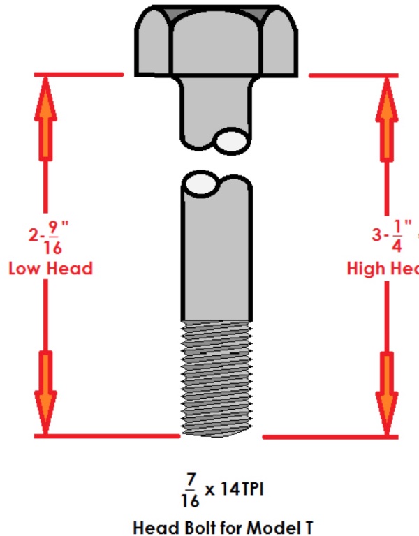

I'm trying to help a friend get his new (to him) Model T ready for the Michigan Jamboree next week. We had to pull the head and in doing so, became suspicious of the head bolts.
They are obviously not original and we question whether they are shorter than they should be. The car is a 1922 with what I think is a high head. How long should the bolts be and conversely, how far should / can they extend into the block? The ones we have are about 2 1/2 inches long.

Typically, the head bolt can thread into the block about 1/2” to 5/8” depth.
The bolt lengths vary on either a low head or high head. But for safety, clean the bolts holes to the bottom to get rid of crud. Then measure each hole with a small dia. stick from the head bolt surface to the bottom of the hole and compare to the bolts to be sure the bolts cannot bottom out.

Sounds like you have a low head.
The front head bolt will be considerably lower than the water outlet bolt. A high head, the bolt is about even with the outlet threads, with the head bolt in the hole.
Use a bottoming tap to be sure the threads are clean and blow out with air.

(Dean - Nice illustration, reminds me, that guy never got around to collecting all of his sketches together so that it could be a handbook of illustrations. He got old...he bought a Mac and left the PC world behind...the software is all different...and he is a stubborn sort of guy (wink) )
