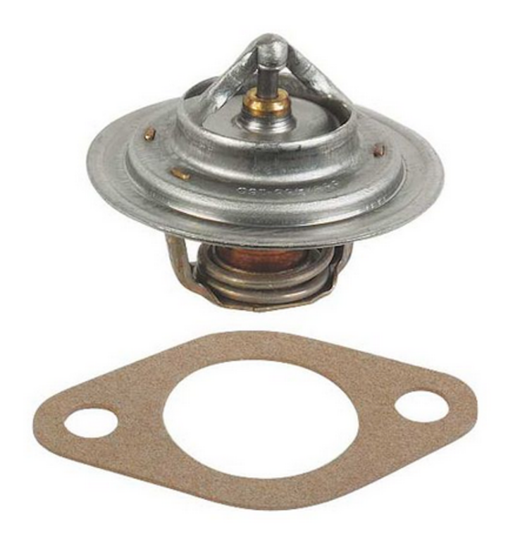

what does a thermostat look like?
I don't get my panties in a bunch if folks want to use these things. It's their money. I'll spend mine on things I need. :)

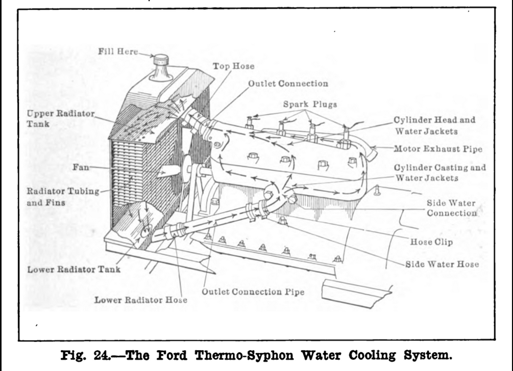

There are many things that come into play to keep a Model T running at its most efficient operating temperature. Most would say that is between 160°F and 180°F in order for the Model T thermosiphoning cooling system to circulate fluid through the system. A thermosiphoning system is intended to cause circulation without the need of a "pump" (more on "pump" later). So how does the fluid flow?
I'm sure your familiar with the saying "heat rises and cold air falls" and that is basically how the Model T cooling system is design to operate.Think of the system as a loop shown in the picture below. The hot fluid being less dense than cold, rises to the top of the system and in a sense is pushing the cooler fluid down in into the radiator, likewise the falling cooler fluid is drawing the fluid down causing the circulation.
The function of a thermostat is act as a valve to block the flow of the fluid until its designed temperature is reached (lets say 160°F). There are two basic reasons to cause the coolant fluid to reach that temperature more quickly - one is for efficient operating temperature especially in cold weather, the other applies to modern car's hot water heating system (not applicable to a Model T).

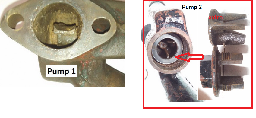

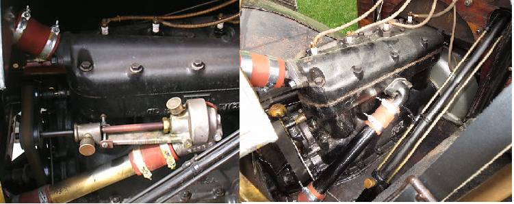

PUMPs
Modern cars don't rely on Thermosiponing cooling. They have a pressurized system (and a thermostat). A Modern car's water pump uses centrifugal force to send fluid through the system while it spins, causing fluid to be drawn from the center continuously. The inlet to the pump is located near the center so that fluid returning from the radiator hits the pump vanes. The pump vanes fling the fluid to the outside of the pump, where it can enter the engine. The fluid leaving the pump flows first through the engine block and cylinder head, then into the radiator and finally back to the pump.
Here's a look at the impeller of two Model T water pumps. Now what is in question is how these would enhance the flow of the coolant when it was already in movement from Thermosiponing? Also if there was a blockage in part of the radiator core would moving the coolant through the system faster make it any cooler or would it reach a point of equilibrium? Personally, I don't see Model T era water pumps capable of moving coolant any faster once operating temperature is reached and the Thermo action kicks in.
Once last point. The fan is only intended to pull air through the radiator while the car is at rest. Once the car gains speed the engine compartment is designed as a closed box to cause a low pressure system with the hood louvers pulling the air through the radiator core out of the compartment. Altering the compartment by removing the engine dust pans (splash pans) or hood defeats the design and less engine cooling.
In summary
Model T radiators went through a series of designs to improve their cooling capacity. Dusty roads may have contributed to clogged fins on the cores. The use of local ground water containing unwelcomed minerals could have also ruined a few. Many owners swear by Berg radiators as the solution to heating issues. If you don't have a problem stick with what you have.
