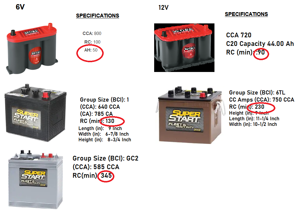

Batteries for modern cars sell based on the CCA specification because the cars have battery charges and alternators to provide power while driving. Model T "starter cars" used a 6 volt lead acid battery (Type Group 1) with a generator to charge them while driving.
Given no starter and no method of recharging then....
There are three specifications related to your battery's ability to provide power whether it be 6 or 12 volt, lead acid or gel or other type.
CCA, cold crank amps,is a rating that defines a battery’s ability to start an engine in cold temperatures. The rating refers to the number of amps it can deliver at 0°F for 30 seconds while maintaining a specific voltage (for 12 volt at least 7.2 volts per cell). The higher the CCA rating, the greater the starting power in the battery. This isn't applicable to your question.
RC, Reserve Capacity, is a very important battery rating. Example for a 12 volt battery, it is the number of minutes a fully charged battery at 80°F will discharge 25 amps until the battery drops below 10.5 volts. Can be confused with Ah
Ah, Amp hours, is a rating usually found on deep cycle batteries. The standard rating is an amp rating taken for 20 hours. What this means for a 100 Ah rated battery is this: Draw from the battery for 20 hours, and it will provide a total of 100 amp hours. That translates to about 5 amps an hour. (5 x 20 = 100). However, it's very important to know that the total time of discharge and load applied is not a linear relationship. As your load increases, your realized capacity decreases. This means if you discharged that same 100 AH battery by a 100 amp load, it will not give you one hour of runtime. On the contrary, the perceived capacity of the battery will be that of 64 amp hours
https://www.batterystuff.com/kb/article ... asics.html
A lot depends on what items are "on" consuming power while driving and/or starting (lights, oils, starter, other), and if the battery being charged while driving. Even though a Model T amp gauge isn't very accurate it can give you an approximation. So lets say the battery isn't being recharged while driving and no starter car. An ammeter in series to measure the draw on the battery and shows -4 amps while driving on battery (doesn't matter what else besides coils). If you have a 400 Ah battery the 400Ah/4amps = 100 hours (likely 10% less) even if the CCA is 600amps
There are many reasons to chose one type of battery over another Placement, starting power, running uncharged, cost, personal preference, and etc. The point of the following attachment is to show differences in specifications because Today's batteries are primarily advertised for what Modern Cars need.

How long a battery will provide a useful level of power (assuming no replenishment) can vary widely. Just about everything affects it, but some of the major factors are: Size, quality, and condition of the battery, including initial state of charge and the effectiveness and quality of regulation of the charging system, if any. How easily the car starts, starter current draw, driver habits, ignition/accessory draw, the ambient temperature, and number of start events are other major players. The condition of the battery is a major consideration. All batteries deterioirate, some faster than others. Batteries do not always deliver their rated power, even when in top condition. In fact, in my long experience, they usually do not. How many times a car will need to be started during any particular outing, and under what circumstances, cannot always be predicted. For very good reasons, most vehicles are provided with some means of replenishing the battery's level of charge while underway. Ford cars have a long history of having alternate means of starting the car in the event the battery fails to do the job. Ford passenger cars through the 1948 model year were equipped with a means to hand crank the engine if the need arose. Ford pickups and trucks through 1952 or 1953 were similarly equipped. To this very day, auto battery vendors do a brisk replacement business, and equipment for "jump starting" vehicles is widely available.

It also depends upon what type of ignition you are running. The E-Timer electronic timer operates much more efficiently than a stock timer, only firing the first spark with the full energy to ensure complete combustion. All subsequent sparks fired while the timer is "on contact" are strictly cosmetic so they are fired at reduced energy to conserve battery life. Just for fun, we ran a test to see how long a tiny 9V (0.33Ah) transistor battery would properly operate the Model T engine. Result: 30 minutes.
By linear interpolation, a 50Ah car battery should run Model T engine equipped with an E-Timer ignition for about 75 Hours or about 10 days of touring 8 hours each day before needing to be re-charged. Of course, this excludes electric starting and Head/Tail light operation during this time.
