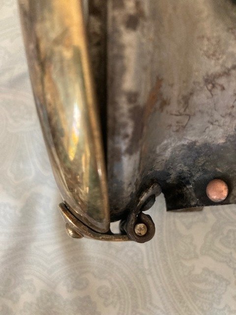

Post by ivaldes1 » Mon Aug 30, 2021 12:35 am
Hi, this 1915 rear lamp door probably isn't original and doesn't close all the way without forcing it then it pops right back open. I think the tang on the hinge isn't long enough. The brass door itself seems to be the right size. It also does not have a clasp at the top. Suggestions on how to get this to work are much appreciated.

The loop on the hinge attached to the lamp body needs to be bent forward. This will both lift the lamp door and move the hinge point forward. As it is, the lamp door is hinge bound.

Take the pin out of the hinge and fit the brass door to the lamp. Then muscle the hinge around to fit the lamp body and reinstall the pin.

After you get the door to close, adjusting that hinge, a clasp or clip to hold it shut can be made from spring wire.
Form the clip to fit across the lamp opening rim, with the wire then bent to a half circle to ride secure in the door opening, in the rolled edge of that brass door.
