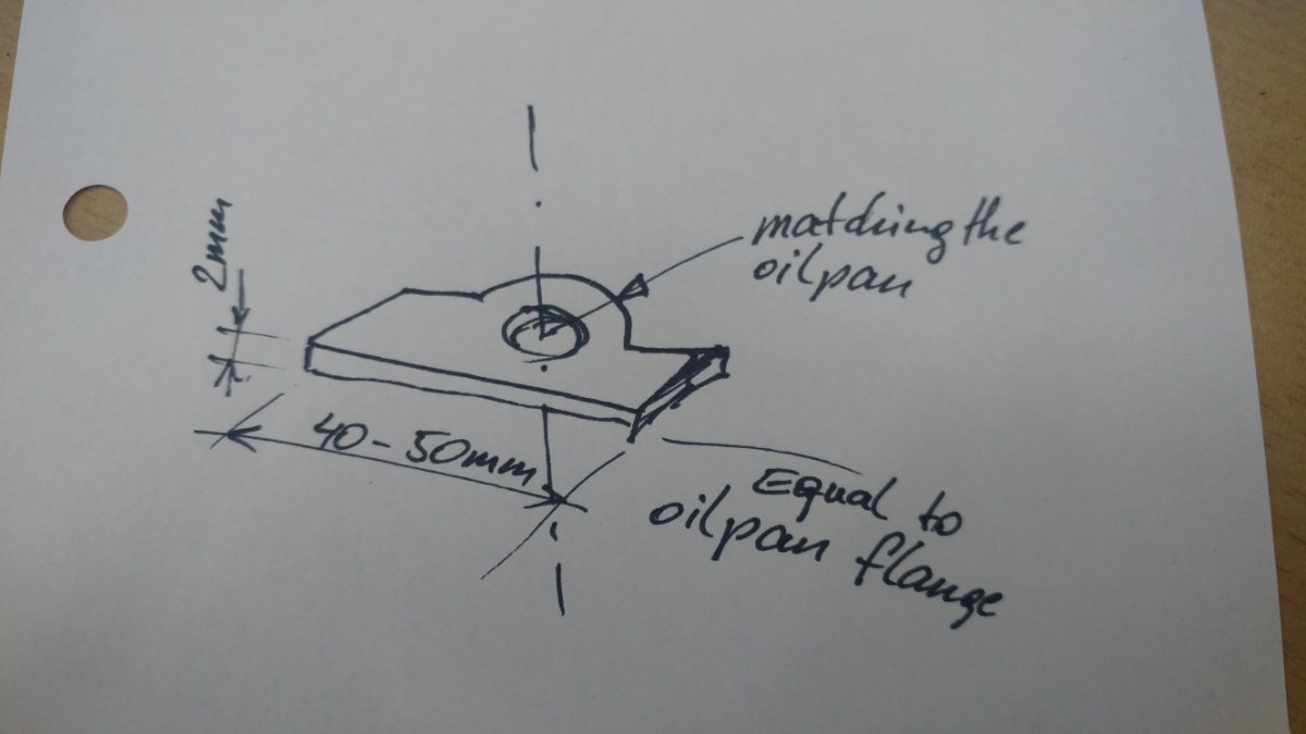

To prevent another deformation of this relatively soft iron I think about laser-cutting special washers of 2 mm sheet metal to be placed between bolt heads and oil pan flange. This will spread the pressure over a wider area and be almost invisible when painted black, too. I made a little sketch below. The "ears" will prevent rotation of the washer and spread the pressure. A thickness of 2 mm should allow using the same bolts.

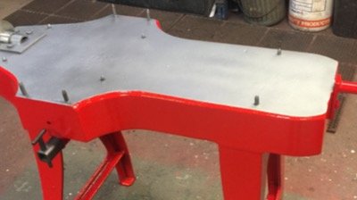

Consider using an oil pan jig to ensure proper fit to prevent leaks.

A bare engine block could serve as a partial jig, if needed. Straightening the pan around the bolt holes and adding the special washers is a good idea, in my opinion. The corner braces are also a good idea. Keep in mind that the T oil pan is a stressed member in that it carries the engine mounts and also locates the radius rod ball, so it is under considerable mechanical stress from engine torque and vibration as well as forces generated when the front or rear wheels encounter a bump or hole in the road. The oil pan has to anchor the front and rear axle assemblies as well as the engine. If a Model T was an animal, the frame might be thought of as the back bone and the oil pan might be thought of as the pelvis.

So I will draw the special washers and corner braces and let them laser-cut at a close company. This way I get all this parts in short time this way.

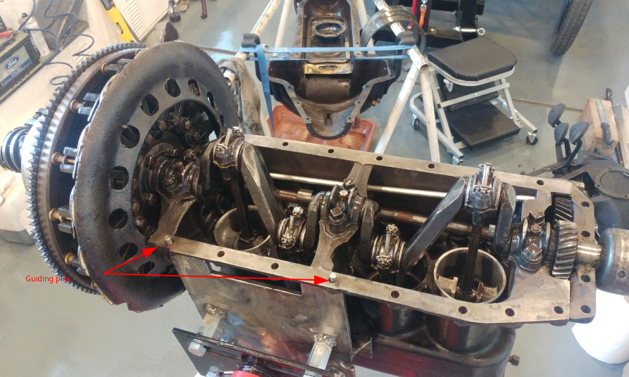

As an engine builder I see 2 issues with your engine, 1, the pistons have no oil holes drilled for the wrist pins and 2, that wire rapped around the rod and wrist pin clamp bolt won't stay there for long, use a spring washer or Henry's way of a cotter pin.

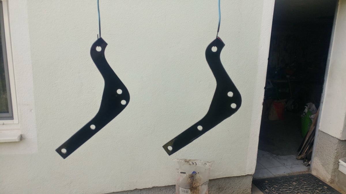

This are my self made reinforcement brackets. They are made of 4mm sheet metal, plasma cut, and painted after grinding and drilling. They have also an extended corner to make them even stiffer.

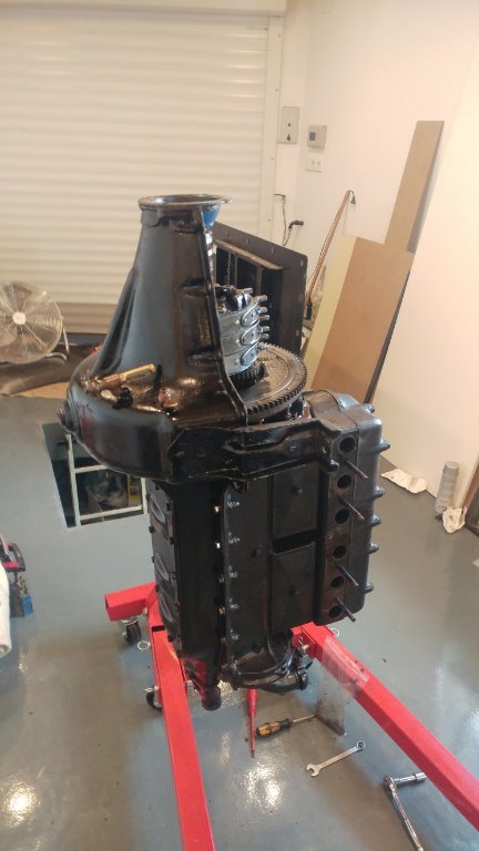

This is the engine with mounted oil pan. I added washers (20mm outer diameter) below bolt heads to protect the oil pan from being pulled up around bolt holes. Both (brackets and washers) led into replacing all bolts by longer ones, but I think this was a good decision.

I flattened this pull-ups and mounted the oil pan now a bit smarter - I used 20mm washers between bolt head and oil pan. This spreads the pressure and prevents any further pull-ups.
