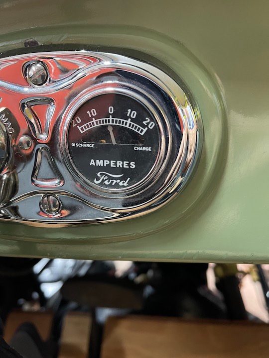

So are all the Amperes Meters at -1 Amp when the ending is off and Bat disconnected? Or just at the swap meet. Seems like they all look like this:
My concern is when I set the third brush. Are you supposed to compensate for that one amp? Or do you just go off what it reads as you make your adjustment?

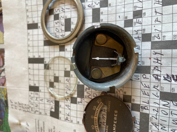

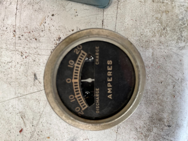

I have never seen one which looked like that one. The pivot point looks like it is not lined up with the dial, however, it still points near zero! Anyway, whatever it reads with everything disconnected is zero amps. If you are concerned about the accuracy, connect an analog ammeter in series with the wire from the generator and adjust it according to that meter. Then with the engine off, remove the meter and re connect the wiring. I have never used a voltage regulator, but I would think it would automatically adjust the current as needed.

Maybe that the issue. The pivot point might be off.

Thanks for all the input. I'll use where it sits as the zero.

In just taking a look at the first pic and not making any comment about the accuracy or use of an amp meter the amp meter in question does look like the needle is not lined up at the pivot point.
In other words the face is either off center or the pivot point is off center.
Maybe it’s because the picture of the meter was taken at a slight angle and not directly straight at it.

It's a chrome plated repop, of dubious quality. If you look closely the 20 on the discharge side is well under the rim of the meter while the 20 charge side sits nicely within the bezel. This shows the face is well off centre, to the discharge side, and still the needle points further to the left. Use it as an indicator rather than an accurate meter.

Mopar_man, it looks like the meter face (thin cardboard on my 1925) is improperly indexed on the meter housing, and someone reindexed the meter in the mount to compensate. If you’re careful you can open up the meter and properly index the face. The cardboard face is indexed to a steel ring which in turn is indexed to the housing. The glass lays against the face, and the plated trim ting holds it all together. (Sorry for the sideways photos, but the forum won’t accept portraits.)

Thanks again everyone. For now I used the place of the needle as my zero and adjusted it from there. I may try to play with the meter face in the future.

As usually the case you guys are right my meter is canted. It's way too shiny to be an original. Same with the switch.

Mine wasn't at 0. I took it apart and bent the needle until it was at 0 and it is working fine.

The pictured ammeter is a very cheap reproduction that is sold for cheap. It is not exactly the type used during 1926 and 1927 and is generally referred to as the "SMALL METER" but the Ford original meter of the same typical size was a better meter. The off center tilt to the needle is common for that cheap repo item. The original larger meters made by Ford were more accurate although some of them "bounce" a bit while you are driving and some makers of the Ford "Large" meter (arrives in 1919 model T's) were better than others that Ford got their meters from. Hoyte meters were better and lasted longer. The ones I got involved with were more accurate than Ford's original versions but that is simply because the technology improved in later years and the movements can be very stable and very accurate (typical 5% of full scale). The small meter just doesn't work very well and Ford never chrome plated any of their meter bezels. Original small maters had a rim that was flat and nickel plated. They were better quality by a mile than current reproduction small meters. You get what you pay for I guess.
