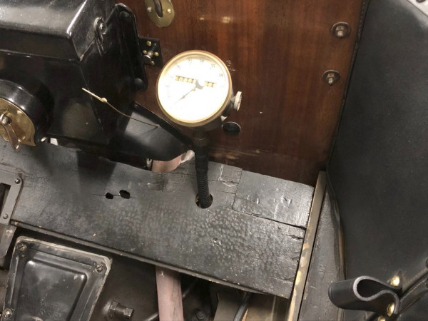

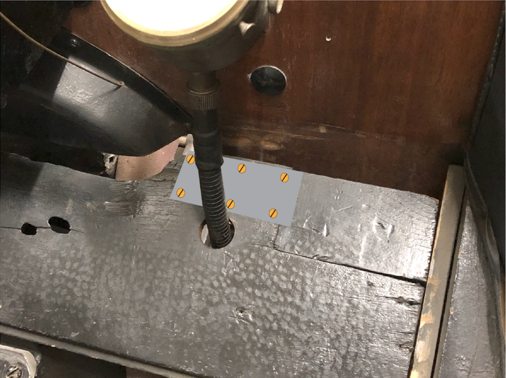

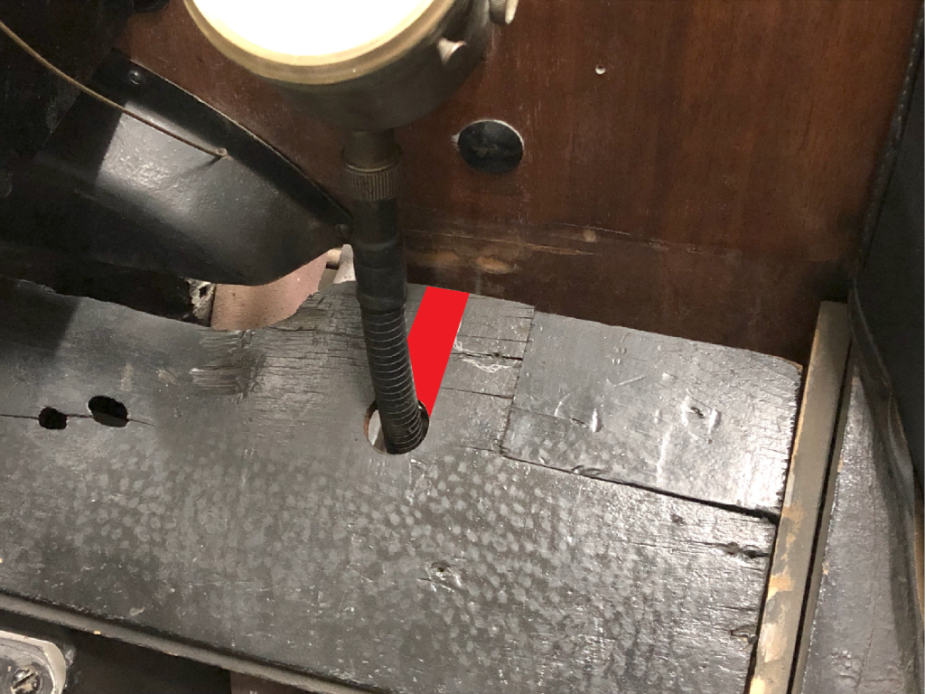

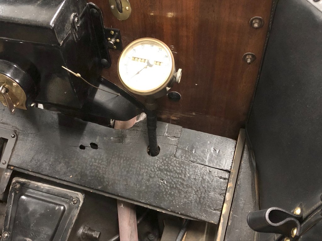

It seems like I'm needing to remove the floorboards fairly frequently for lubrication and service. On the '23 this is simple & very quick. The '14 is a different story. The floorboards can be removed fairly easily but the top toeboard is another story. It is trapped by the speedo cable. I understand from reading the Club publication that reattaching the speedo cable has a trick to it and that if done improperly the cable and possibly the speedo itself might be wrecked.
I'm going to have to remove the cable to free the toeboard but I would like to minimize the need to do this EVERY time I need to clear the decks for work in that area. Looking things over it seems like a saw cut could be made that would remove enough wood to allow the board to slip out. This might leave to board weak so a metal plate could be screwed over the area. The wood section removed by the sawcut could even be screwed back on to provide some insulation.
Future removals would require removing the four wood screws but not the cable.
In the pictures, the red area is the proposed saw cut, the grey area is the metal patch plate.
What do you think? Has anyone done this already or have a better idea? Is the cable really not that hard to reinstall? If so, there might be no need for any of the modifications.
Paul
Paul

You might want to remove the original board and use it to make a pattern, then cut a repro board and modify it to accomodate the cable. The repro could be "distressed" to match the rest of the floor and the original piece stored.

The Speedo cable on my ‘14 Ford Special runs along inside the firewall. So I just cut a circular notch out of the forward edge of that forward floorboard.

Factory 1914 floorboards have a notch in them to accommodate to the speedometer cable so you don't need to disconnect it in order to remove the floorboard.
You have some mickey mouse going on as it is such as the large notch in the floorboard to accommodate the 1919-22 dash shield so I wouldn't get hung up on cutting the notch for the speedo cable.
Also, If your car had a "Ford special" speedometer or a regular Stewart speedometer that was correct for the car, the back of the speedo would be flush against the firewall with the cable coming straight down from the side of speedo housing, not a speedo mounted on an angle bracket and an angled cable mount.

Paul, the problem is likely the speedo head. Usually it is not mounted at such an angle, and the cable roughly follows the firewall. Thus, all that is needed is the afore mentioned slot in the top edge of the floorboard. If your top floorboard fitted more closely to the firewall, as it should, your problem would be even worse.

I did not understand that the dash shield was a later model. The speedo is a 1912 model and works fine. The existing floorboards are very old and have all sorts of dings, holes & even a patch. It does fit somewhat better with the lower panels in place.

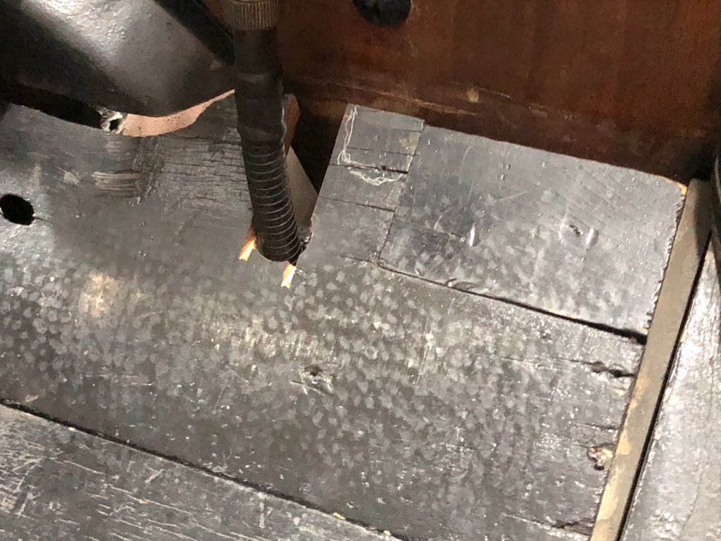

If you choose to go with the slot as discussed, the speedometer cable slot in
my original July 1913 top floor board is 3" x 3/4" centered 4" from the right end of the board.
This is directly above the factory hole provided in the splash shield where a grommet protects
the speedometer cable and would work nicely with your beautiful speedometer as you have it.
To avoid breaking chain links (the trick you referred to) when removing and replacing
cable to speedometer head:
Before reattaching cable to head,
Jack up right front wheel (with swivel and road gear) and spin wheel as if car were moving forward.
The chain links will now be "flipped", oriented, in the proper running direction.
Seat cable into speedometer head and tighten the knurled cable nut to the speedometer head*.
*You can move the position of the speedometer head drive slot with your fingers to line up slot
and seat in the cable .
This avoids "pushing" the chain links which leads to the breaking problem.

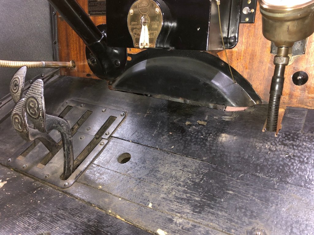

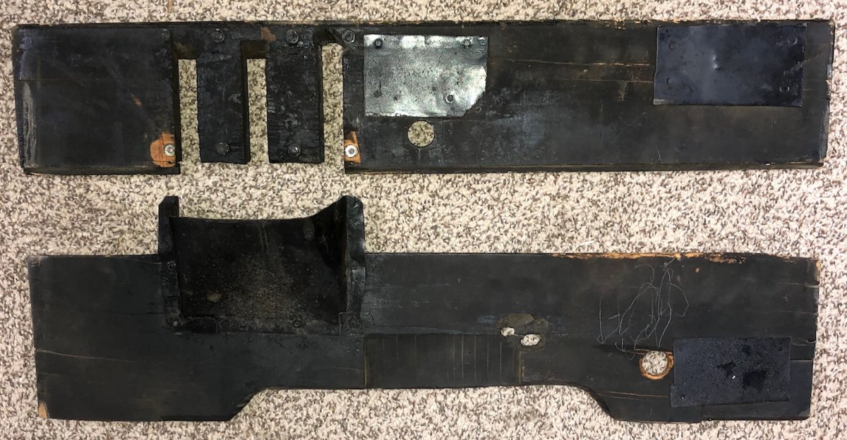

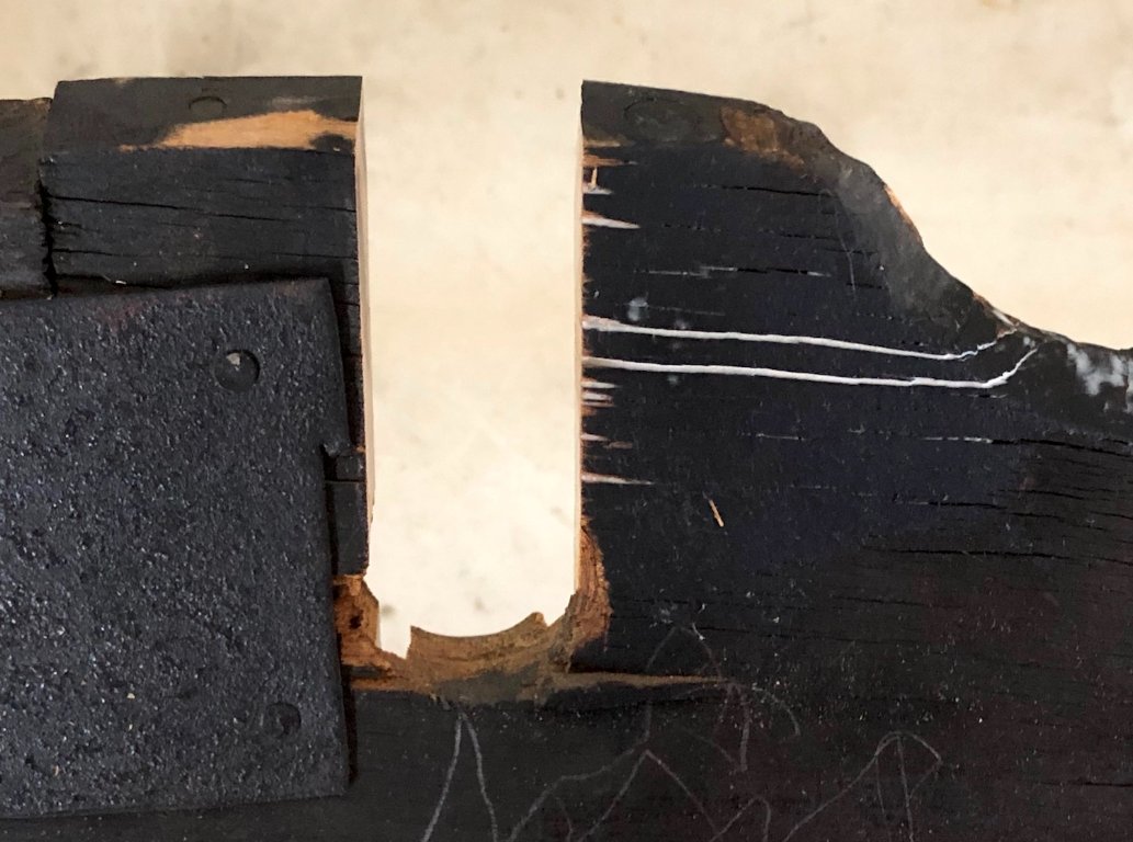

Over the weekend I had a go at the toe board mod. The speedo drive came off cleanly and was somewhat wet with grease. I'm glad it wasn't dry. As soon as the cable was loose the toe board came off and the speedo drive reattached. This turned out to be much easier than I had feared. The drive portion of the speedo head stood proud of the housing and with the help of a flashlight was easily adjusted to fit the drive key in the cable. I jacked up the front wheel and spun it then watched the speedo needle register 3 mph. There was no noise or sign of mechanical distress so I feel I probably got it back together correctly.
The floor boards show much damage & many repairs. Someone had thought of using patch panels before I did! I ran the toe board through the table saw to cut a channel for the speedo cable and got a bit enthusiastic with the saw but nothing that can't be patched up with putty and another patch panel.
Someone thought that this is the wrong dash shield. There is a better picture at the bottom here, is this certainly wrong? How would the correct one look different?
Paul

The metal dash shield for 1914 would be flat steel and not shaped like a pie pan. Looks like you have a little more work to do.

Any idea why someone might fit a later dash shield? This motor is later from 1919 with a starter. The dash shield would not seem to interfere with anything I can see.
