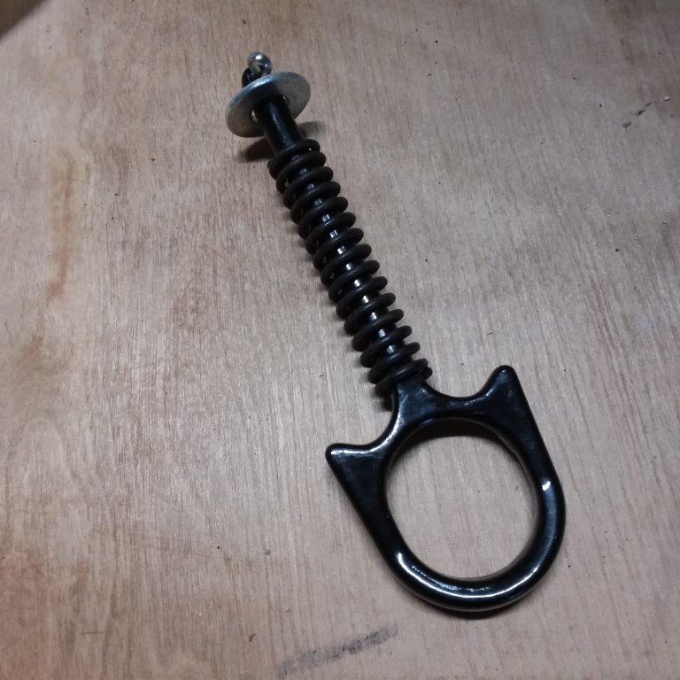

On my '26 the rear hood latch's went on slick. The fronts are an issue. The springs that came with the kit are too long to even fit/compress between the c shaped frame rail.
Am I to cut a few rounds of the spring off?

FYI
a) there are wood blocks which belong between the sheet metal hood strip and the frame rail
b) the washers supplied in your kit are too large and should be JUST smaller in diameter than the holes in the frame
c) the whole mess should be pre-assembled on the bench and then lowered onto the car...no fiddling with cotters in a confined space inside the frame rail or under the splash apron

Re: HOOD LATCH SPRINGS
I have the wood blocks.
Don't have smaller washers.
And there's no way the assembled headache will go in thru the frame from above without substantial drilling. Not drilling. Gotta be another way. Like cutting the spring length down.

Buy smaller washers or grind the OD down to fit through the holes.
Make the washers you have smaller. File or grinding wheelProfessor Fate wrote: ↑Mon Sep 13, 2021 4:32 pmI have the wood blocks.

I just got through installing one on a 20. I used a large washer and it fit under the frame. I had trouble getting the spring compressed to put through the cotter pin. I put the handle with the spring on it in a vise and used a thin piece of stainless wire through through the inside of the spring. The handle shaft fit through the spring with that wire inside. I compressed the spring in the vise and twisted the wire to hold the spring and then went back to the car and installed the rod through the sill, frame, washer and spring. I was able to get the cotter pin in place then I cut the wire. It works.

Had the same problem.. I used roll pins instead of cotter pins, smaller washers and enlarged holes in the frame - worked better. Also cut 2 loops off each spring.. still have plenty of tension to hold your hood during normal operation.. but I remove hood when on my open trailer at highway speed.

A local parts store should have metric 6 mm ID with a smaller OD than yours. Normally fixes that problem.

Get washers that the ID fits the latch "shaft".
Put on a spring and one or more of the washers.
hold the whole mess against the wheel on your bench grinder until the OD of the washers is the same as the OD of the spring.

Have this problem disassembling customer cars. The washers need be no larger than the spring diameter. I have used flat washers designed for counter bored allen bolts. They matched original washer size close. Standard sae are way too large.

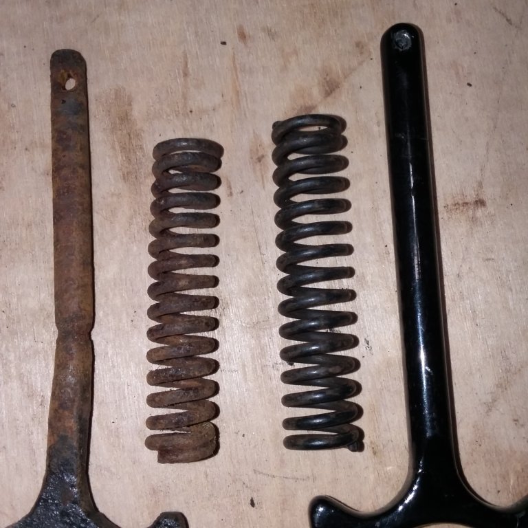

Professor Fate
Topic author - Posts: 773
- Last Name: S
- Location: Taxachusetts
Visual comparison.
Measured the old spring is thinner and shorter than the repop.
