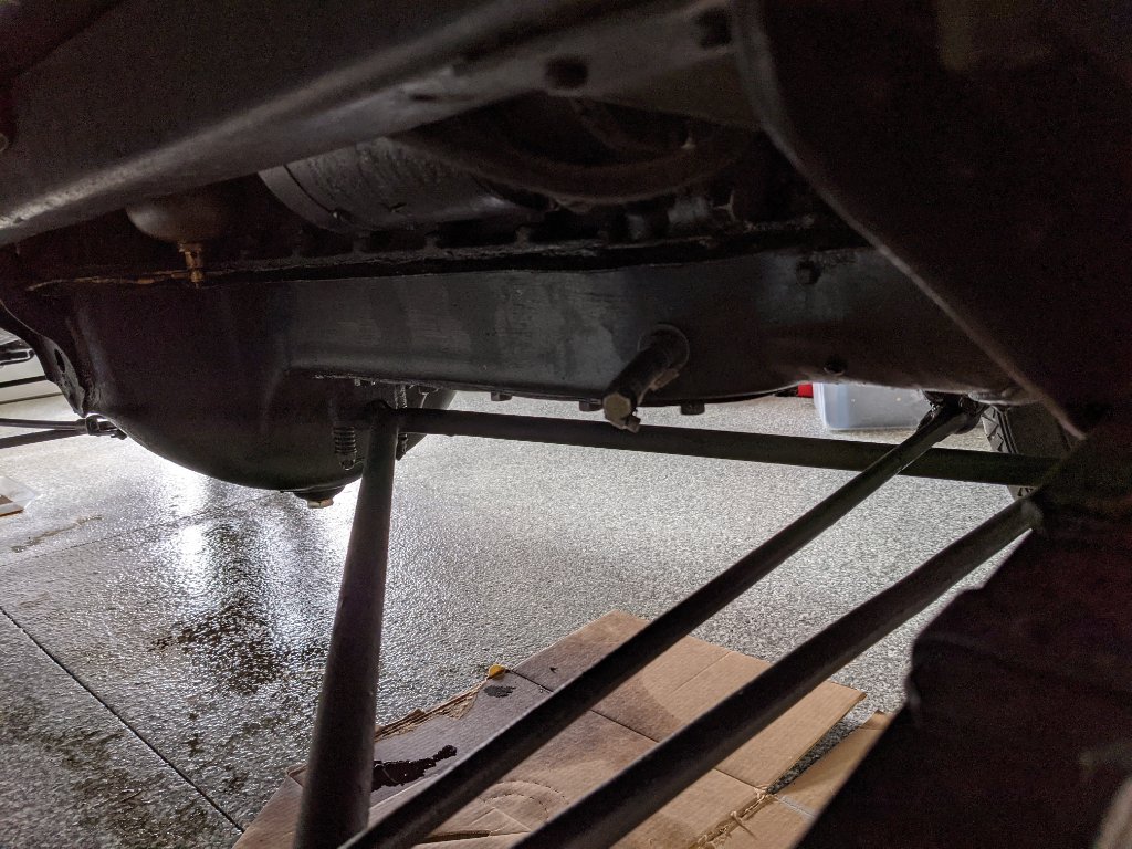

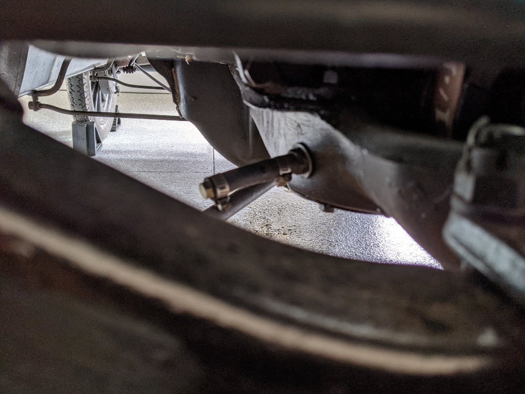

I have this tube coming out of my 1920 engine. Can you all tell me what it's for?

Post by CudaMan » Sun Sep 12, 2021 3:31 pm
Maybe it was a return for an external oiling system that somebody blocked off with a hose and clamped nut?

Post by TWrenn » Sun Sep 12, 2021 3:52 pm
Whatever it is I'd get rid of it and plug the outlet opening tightly! That looks like a disaster waiting to happen.

Post by MichaelPawelek » Sun Sep 12, 2021 4:58 pm
Someone in the past may have been trying to keep the front dip full of oil for driving up very steep hills. I would cap it off right at the pan.

Post by Mark Gregush » Sun Sep 12, 2021 9:58 pm
Why take if off, just add a Sure-Feed type oiler to the transmission cover and use it.

Post by kmatt2 » Mon Sep 13, 2021 1:41 am
From the pictures it looks like it is on the right side of the motor. You will need to use a Ford Faithful type oiler that replaces the stock transmission inspection cover, Chafins is making a repo I think. The Sure Feed oiler comes off the left side of motor and wouldn't work.
From the pictures it looks like it is on the right side of the motor, yes right side.

Post by JBog » Mon Sep 13, 2021 10:29 am
Yea, it's on the passenger side of the tourer.

Post by Mark Gregush » Mon Sep 13, 2021 11:46 am
http://www.mtfca.com/discus/messages/17 ... 1311799547
http://www.mtfca.com/discus/messages/41 ... 1401574008
There were a couple of different brands, but work about the same. When I install mine, I will be feeding in from the location you have that fitting.

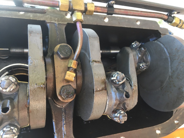

Post by TRDxB2 » Tue Sep 14, 2021 11:21 am
Another possibility to where it might go - but unlikely. What do you know about your engine?
