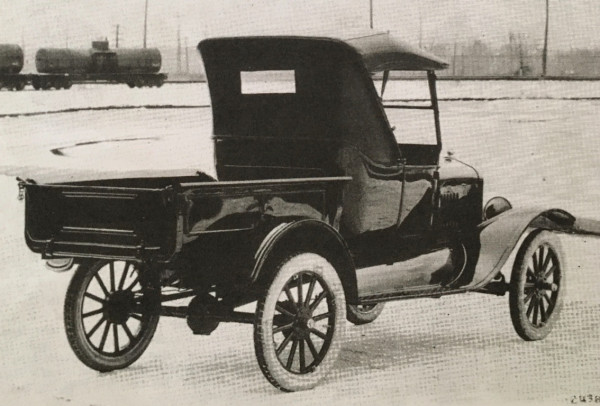

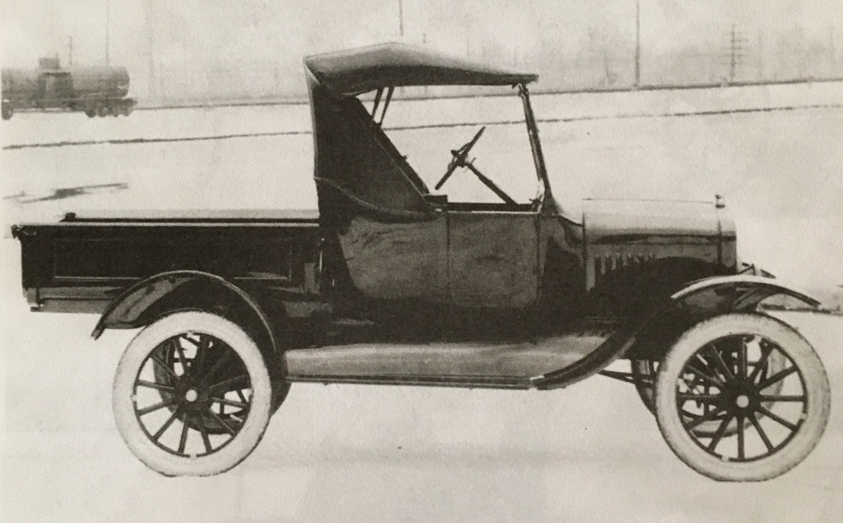

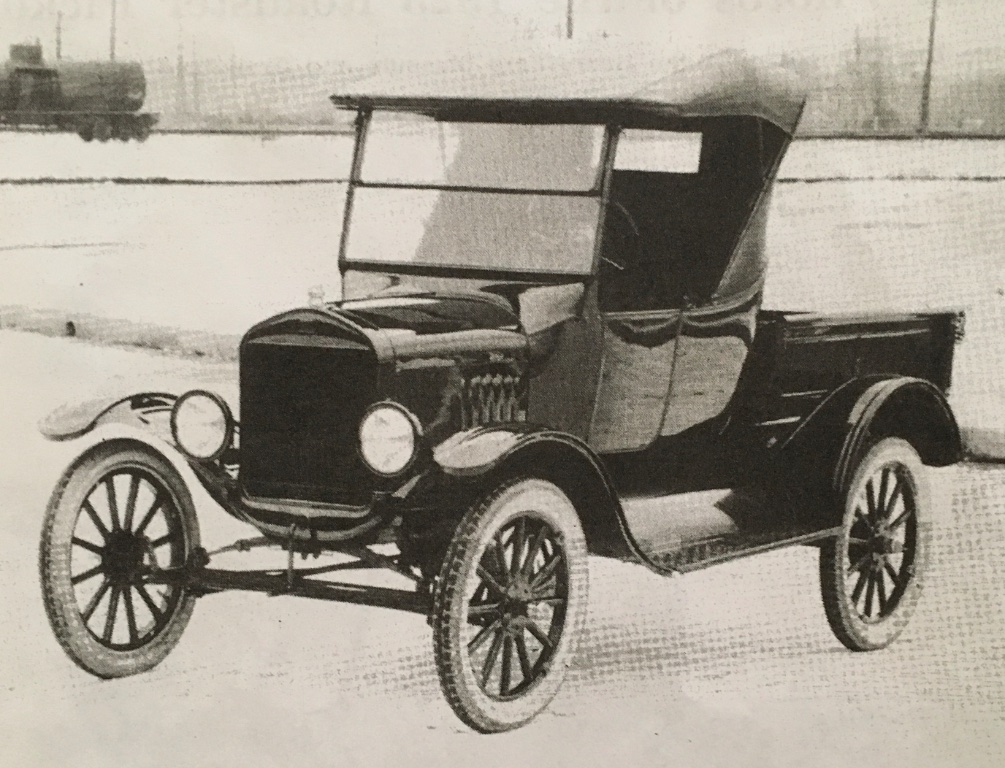

The above are the factory photos dated Dec 12,1924 and there is another set dated Feb 28,1925 showing the same box lacking the Ford embossment on the tailgate. (Ref: Bruce McCalley’s book “Model T Ford”).
The 1925 boxes were only made for 4 months before the change over to ‘26-‘27, if I understand correctly by Bruce’s book, the very early boxes didn’t have the Ford script on the tailgate.
But by then Ford was stamping parts-so it should be on there somewhere.
Not being a manufacturer, Sears and Roebuck would have drop shipped or bulk purchased from an outside supplier.
(From Ford most likely)

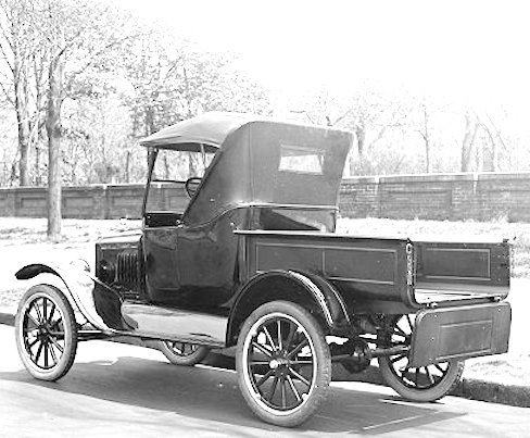

You might want to check again other photos of those 'early' non-embossed tail gate pickups.
This view shows no Ford script emboss on the open tail gate. But does show the 1925 style rear window, the 1925 style 'commercial fender' so-called, that has wide embossed molding going under the splash shields.

On the very first photo posted, the rear mudguards are standard, curved in rear fenders. There is no need for straight Hack style fenders with the factory pick-up bed.
Or have I mis-interpreted your "straight fenders'" ?

That’s interesting Dan! I’ve never seen that photo, do you know the date it was taken?DanTreace wrote: ↑Tue Sep 14, 2021 3:22 pmKevin
This shows proof then that the non embossed tailgate beds found their way on 1925 styling equipped cars.
Would it be safe to say the first 1-2 months (of 4 month’s) were the non embossed tailgate beds?
