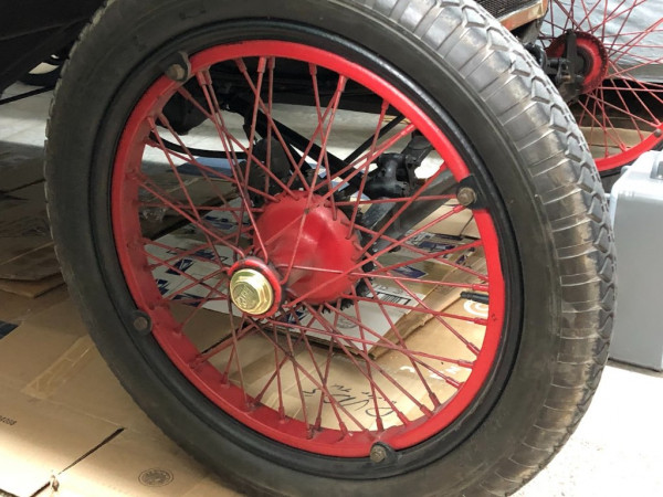

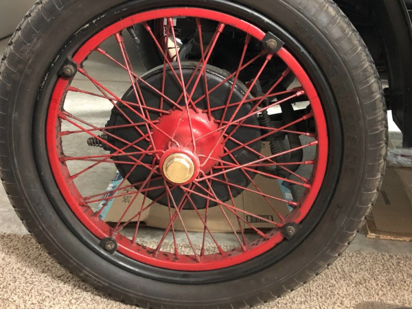

I had dismissed the wheels as the car has phases where it runs along very well. This car is an older restoration with nothing known about its history over the last 50 years. I do know it has been driven very little in the last ten years or so.
I do not drive this car very quickly. It likes 25 - 30 mph, and I have never driven it faster than 37 mph by the speedo. The car just doesn't feel happy going very fast. Only twice have I felt any shimmy. Both times while turning a low speed corner and it went away right after the corner. The steering is pretty tight but not perfectly tight. It is certainly tighter than the '23. When going down the road, it is stable and needs very little correction. It really is a pleasure to drive. Only the vibration is worrisome.
I will make a list of the items to check and have a look this weekend to see if I can find any issues. Thank you all for the suggestions. I DO hope the wheels are OK as I am a very long way from a wheel shop.
Another thought occurred to me this morning. The '23 has the same wheels. I could swap them out and see how the '14 drives with the '23 wheels & tires. If the problem goes away, I will know the issue is with the wheels & tires.

Post by Hudson29 » Thu Sep 16, 2021 7:20 pm
I do not think the vibration is motor speed related. When going through the gears (this car has a Ruckstell) I do not recall feeling it. The motor is actually very sweet running if not very peppy.
I think the best thing now would be to get the car out again with information posted here fresh in my mind and see if I can pick anything up in better detail.
I've been involved with Model Ts for a good many years and have ridden as a passenger in quite a few. I have only driven my own so I have little to compare the experience with.
Paul

Post by Hudson29 » Mon Sep 20, 2021 7:38 pm
I had a poke around the '14 this Saturday to see if I could find some items in the steering system that might need attention. I started with the steering bracket. While it has no movement with respect to the frame, there is quite a bit of slop in the lower bushing. Moving on to the kingpins, the left top is also pretty loose. I could not feel any slop in the bearing. On the right side I found some minor movement but could not see where it was. I laughed when I saw the slop in the drag link on both ends! I did not inspect the tie rod ends, I'll get to them when doing the rest of the steering.
I jacked up the front wheels and spun them to check for wobble & radial runout. There was not too much wobble by Model T standards but the left wheel seemed to have a lot of runout not connected with the flat spot from sitting a week. This will need more careful inspection after the next run.
The work list on this car just got longer. The real question in my mind is why the car steers as well as it does. Will any of this make the car shake? I dunno, but it sure can't help.
The steering bracket needs to be rebushed and I read someplace that it needed machine work. What is involved in getting this done?
Are kingpins something the home mechanic can do with basic tools or is this specialist work?
Paul
