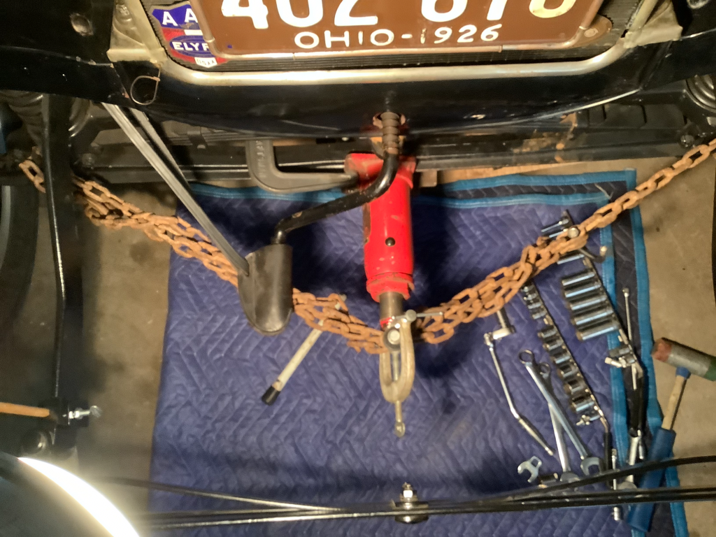

Richard , it’s best to straighten an axle as a bare forging, and lots of archival info on that method. If you aren’t willing to take it all apart, here you go. This got me in the ballpark, and will work until I do take it all apart. A good friend noticed a bend on my axle , probably from someone with a tow strap. I would get an occasional death wobble, even though every bushing and ball joint had been addressed. Toe-in was checked after straightening and right on now, no more death wobble.
A bottle Jack, a chain and a long straightedge, worked for gramps, it worked for me.

Yes, and yes, it got worse after straightening. It was visibly bent and I never noticed it. Thanks again, Joe A. , it did the trick.

The toe-in was off just a smidgen before the axle straightening by eyeball/straightedge. After straightening it was off about a 1/2” , which would be expected. So then I brought it to where it should be. Been great since.
When building a car, it’s a lot easier to straighten a naked axle first, fer sure!
