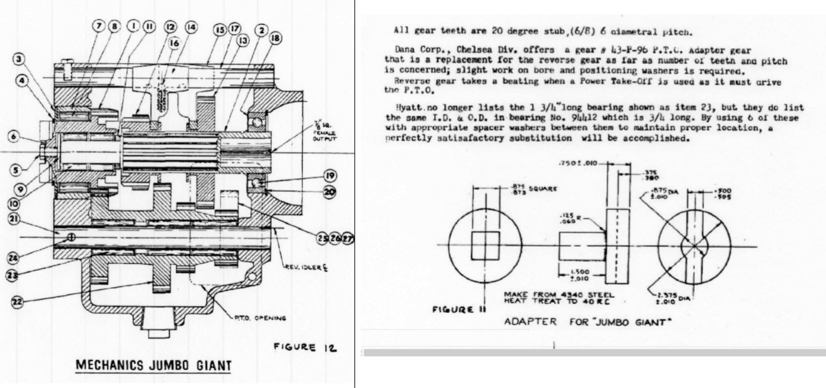

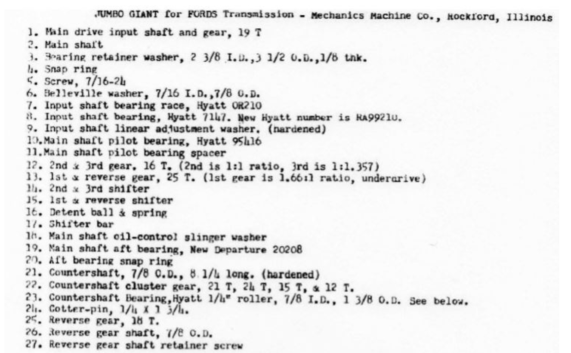

Would anyone have a list of replacement bearings for this transmission?

Not done searching appears to be another reference that this was taken from http://www.mtfca.com/discus/messages/50 ... 1420996116

Thank you Frank. That information is very helpful.
