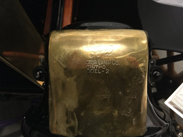

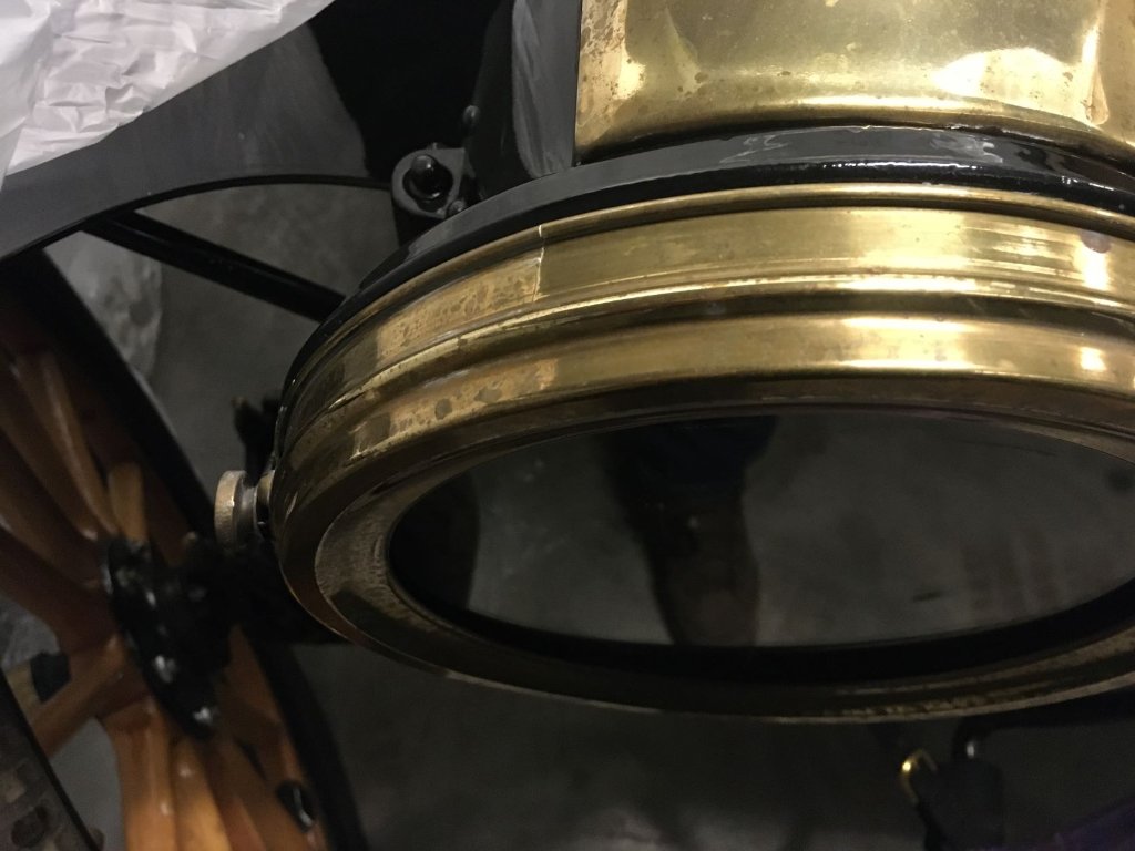

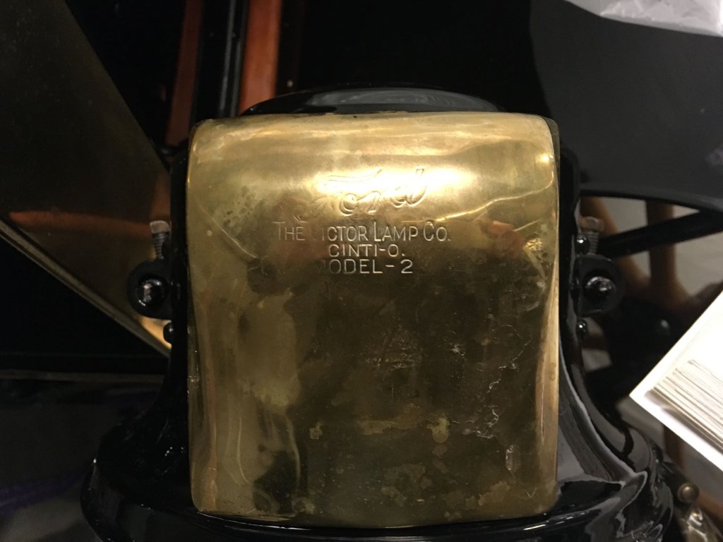

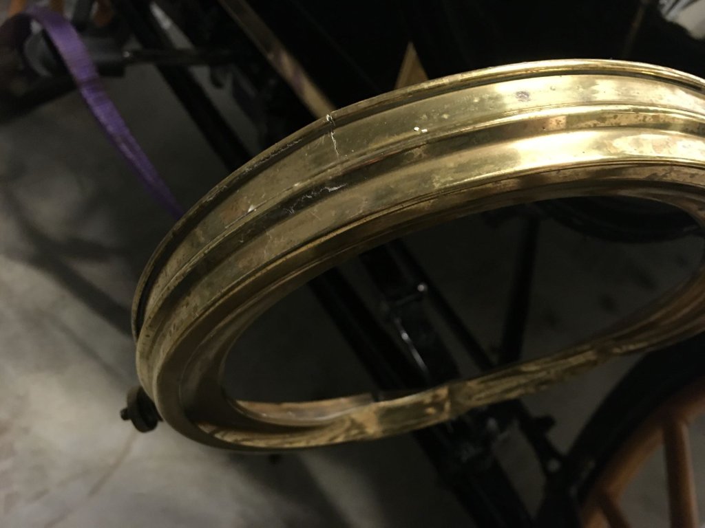

I am looking for a usable headlight door for one of the Victor 2 gas headlights on the 1914 runabout.
Can some one help me?
