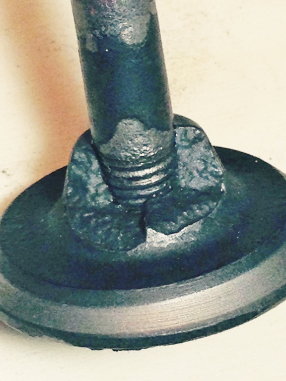

Usually the give away is the twin holes for lapping forked tool. Also, if the surface is clean, you can see the stem junction.
Busted iron valve top, original 2 piece Model T design steel shaft, iron head.jpg
Busted iron valve top, original 2 piece Model T design steel shaft, iron head.jpg (86.73 KiB) Viewed 3492 times
Underside is clearly showing the steel stem, and the cast iron head.
The all steel valves were in the very last motors, around May 31, 1927, except export engines, and service stock was avail. after July 29, 1927.

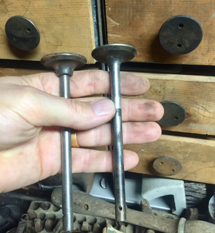

As mentioned the Model T only used two piece valves. Here is an example of the later two piece steel head next to the cast head:
Note that the steel valve has a gentle taper that stands out from the cast head:

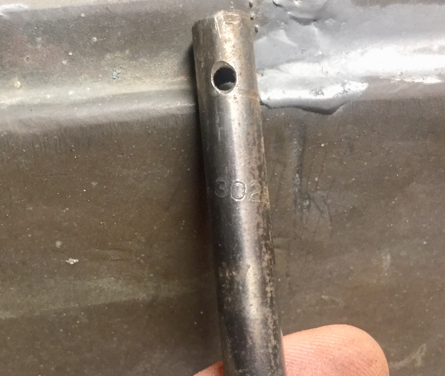

The steel head valve is marked on the steam “Made in the USA 3025”
And I tested it is not magnetic. That was something new to learn. I guess we should call it alloy steel head because carbon steel should be magnetic.
I disagree with anyone who says two piece valves are worthless. See the background of the photos. They make great handles for my bolt bins!
Enjoy!

Hey Matt, I like those drawer pulls !

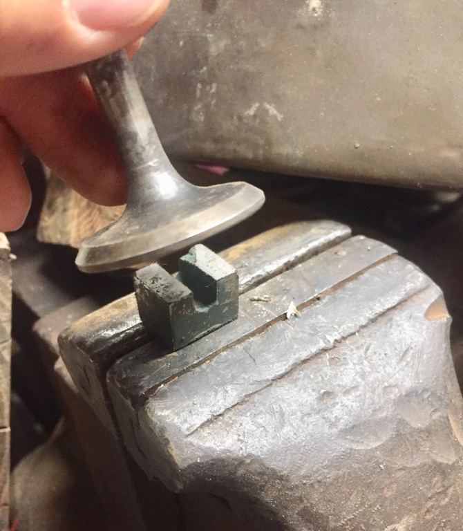

Post by Matt in California » Fri Sep 17, 2021 12:44 pm
Thanks GG,
The price was right for the pulls! It just cost me some washers and time to cut and pean over the valve steam:
