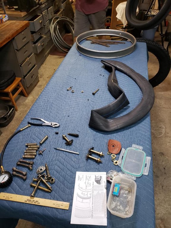

The tools of the tire shop trade.. vintage brass valve stems are in the bottom right..

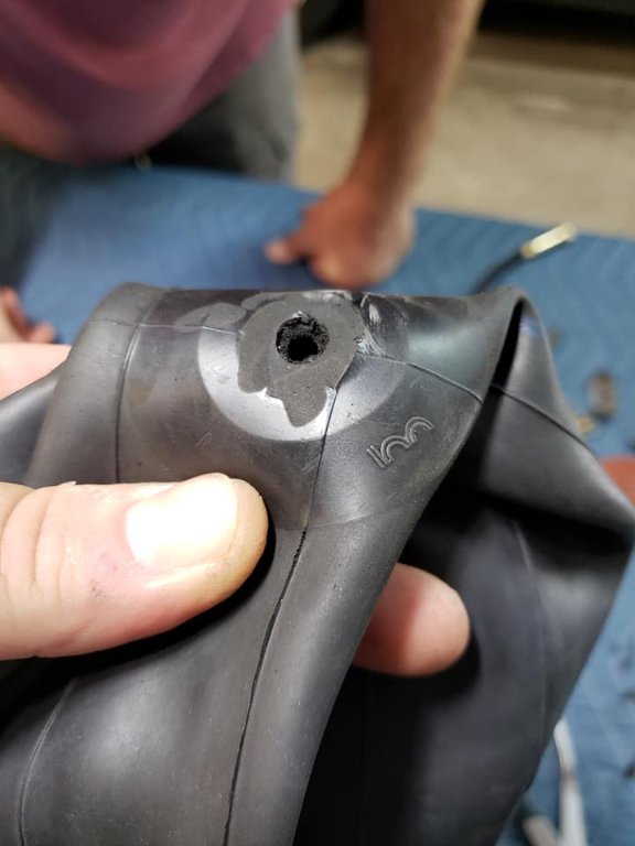

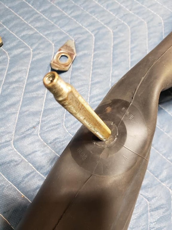

Using an Exacto knife, we cut the sub-par rubber valve stem off the brand new tube! After this photo, we took the tube to the grinder wheel to smooth out the cut, before mounting the valve stem. Makes the tube nice and smooth. Boy i hope this works!

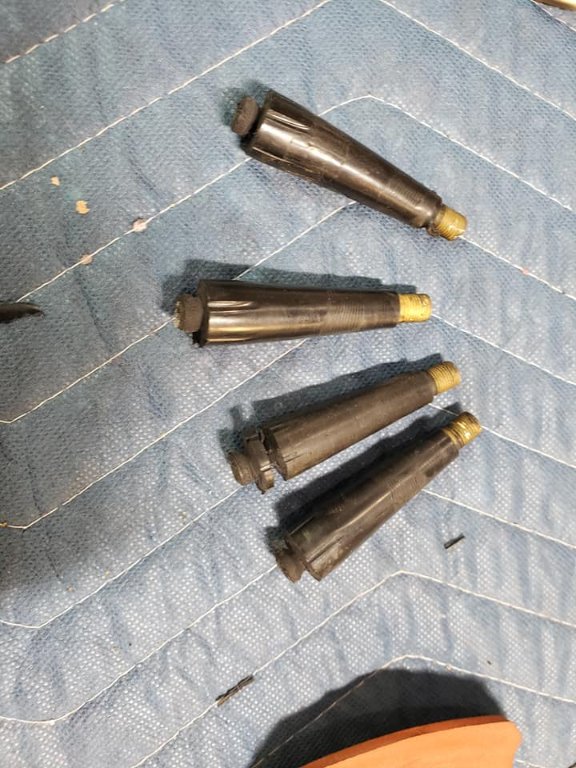

The new valve stems we removed. They are vulcanized to the tube. If you notice, there is hardly a flange at the bottom to reinforce the attachment to the tube. On the other hand, the flange on the brass stems is about the size of a quarter and ribbed for sealing to the new rubber tube when the tube is crimped between the flange and the ribbed bridge washer.

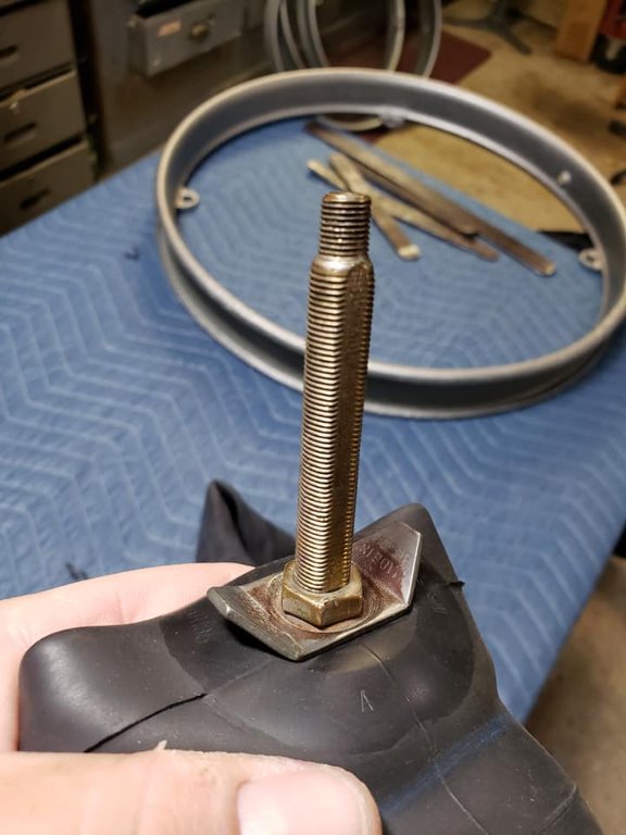

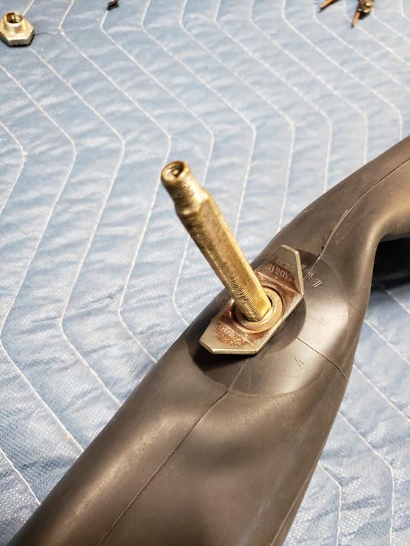

New valve stem placed into the tube. Fits like a glove!
Bridge washer goes on next. The tabs get tightened against the rim once the outer nut gets installed. Notice the dimple ring in the washer, this rib mates with the flange on the inside, squeezing the tube in between creating an air tight seal.

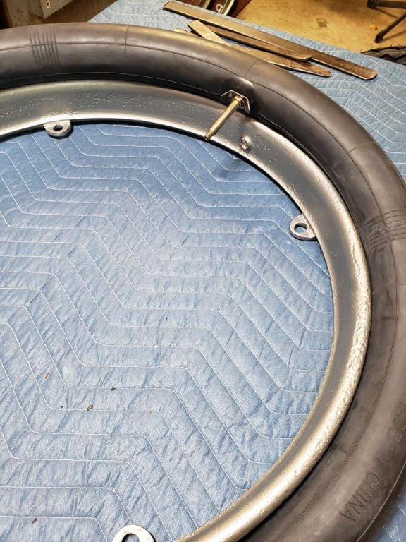

Inner retainer nut gets righted against the bridge washer and the stem flange inside the tube, creating an air tight fit.

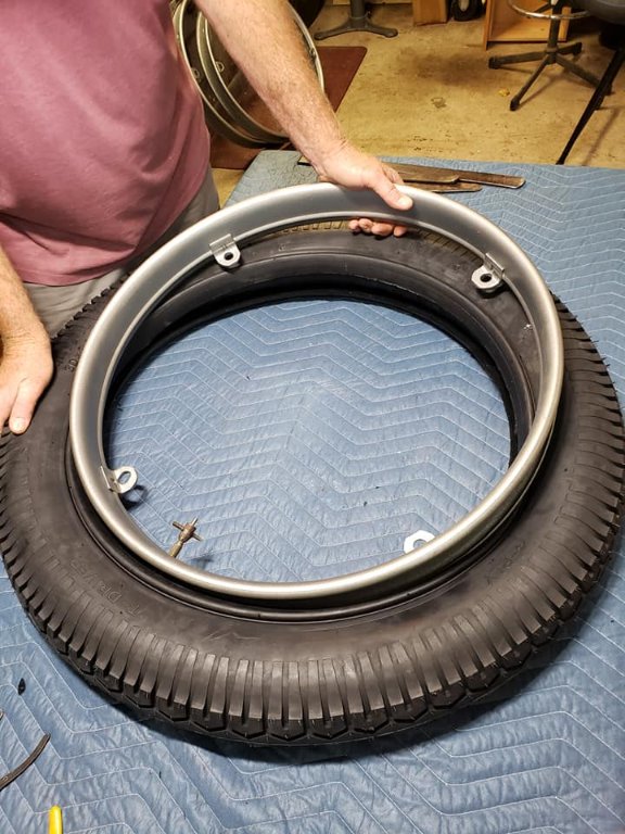

Rim and tube...
Rim and tube...

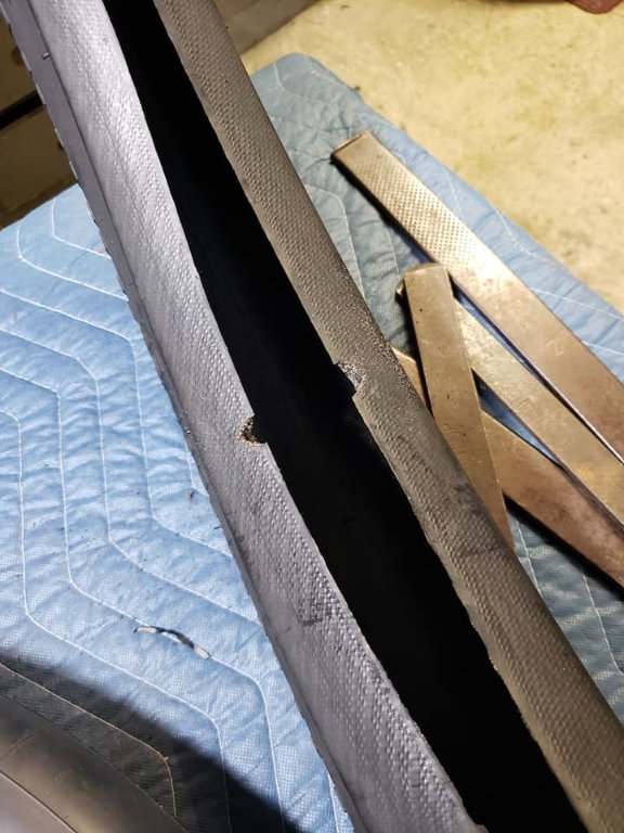

Newer clincher tires get a little close inside the rim, so a relief cut is made for the brass stem.
Relief cuts complete.
Tube and flap inside a new Universal T driver tire!

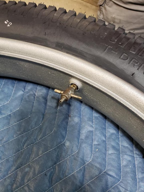

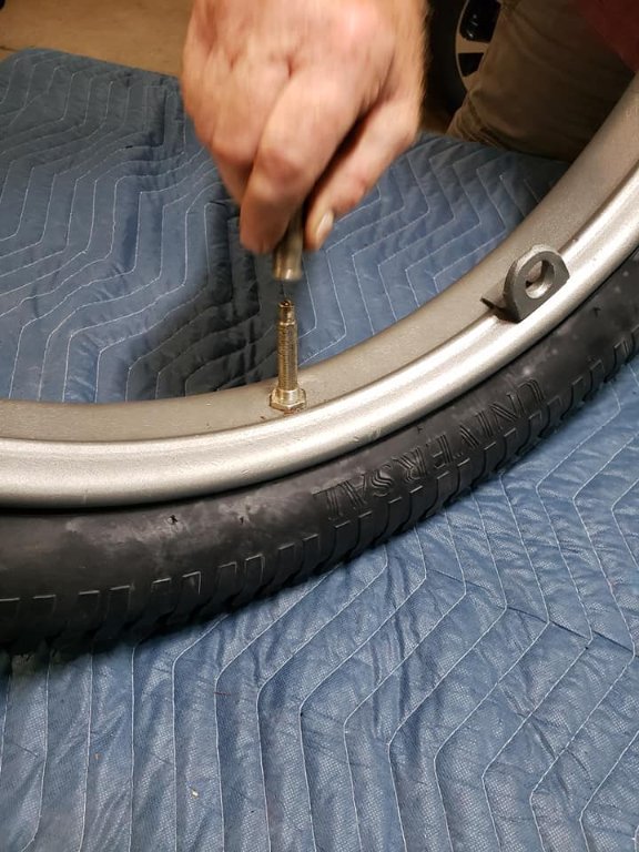

The schrader valve tool is placed on the stem temporarily to keep it in place.

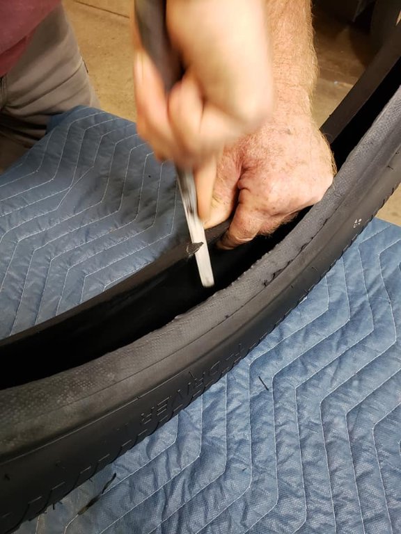

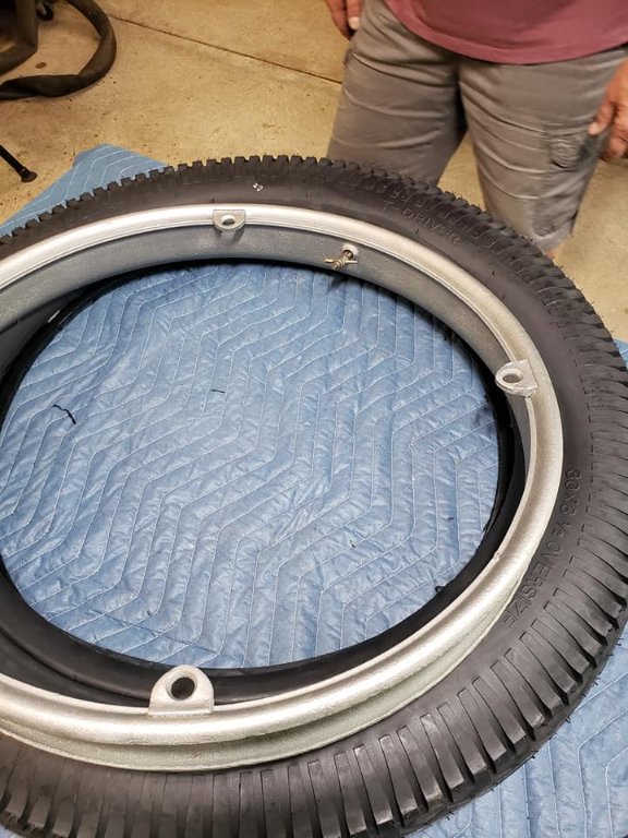

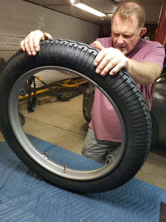

Starting to mount the tire. Dad uses tire irons while I hold the tire down

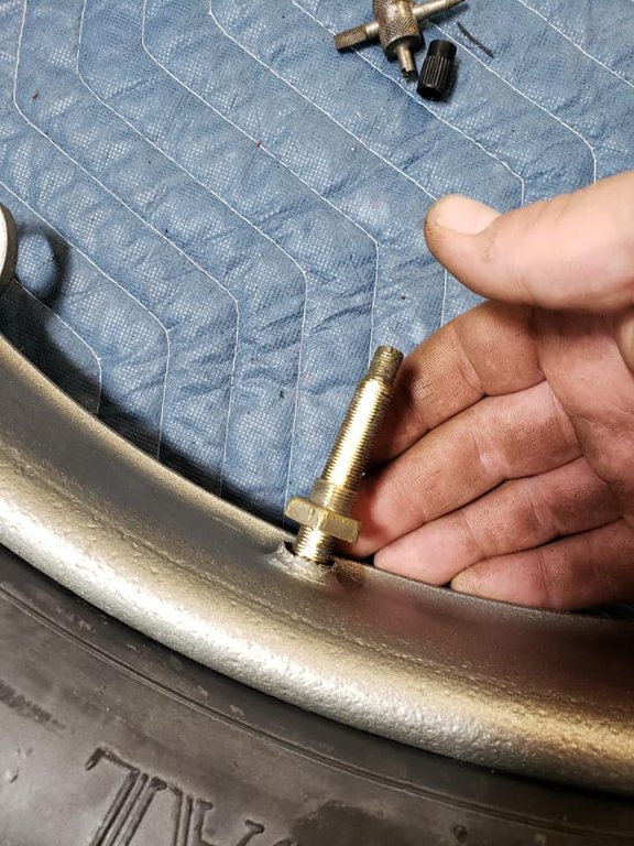

Tire mounted! I prematurely installed the outer retainer nut. This actually goes on the outside of the steel feloe of the wooden spoke wheel.
Checking the clincher bead seated in the rim.

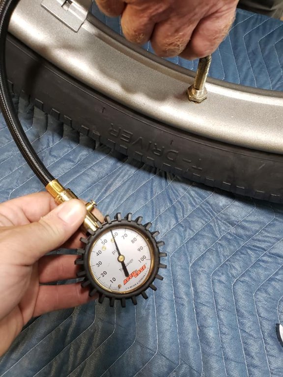

You eyes are not fooling you! 60 PSI is needed to hold the clincher tire against the rim. These are high pressure tubes and tires!

Again, the wrong location. Goes inside the steel feloe, but showing close up of it anyways.

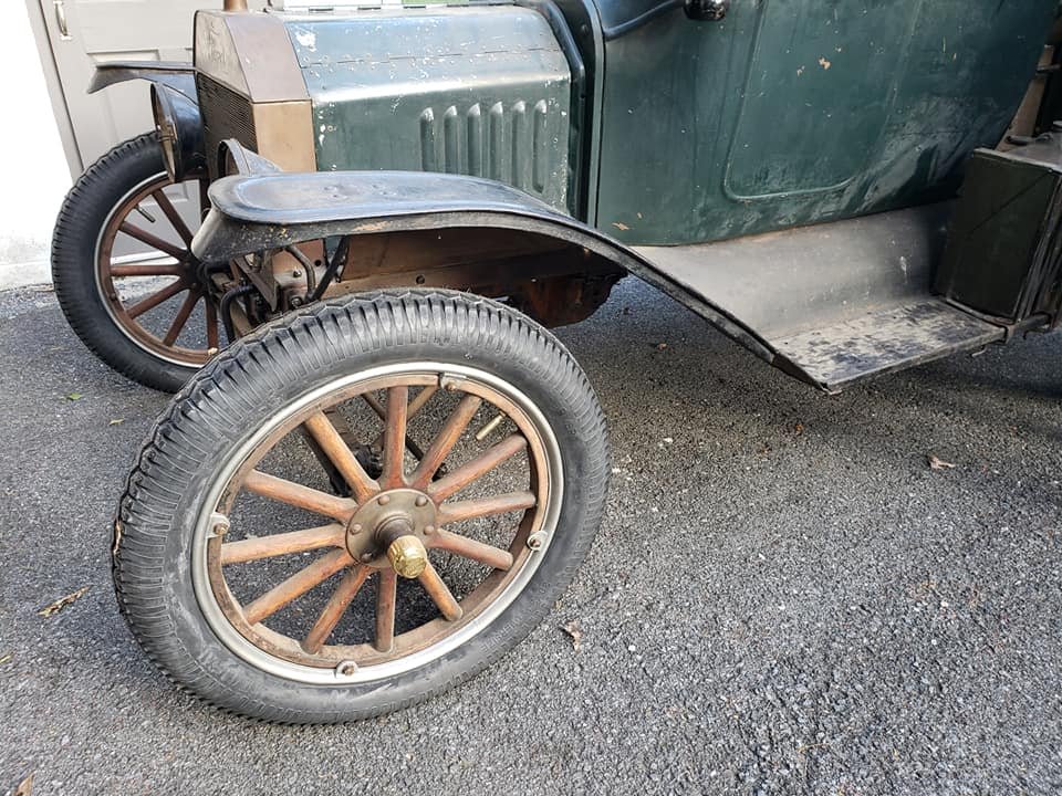

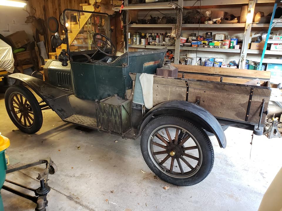

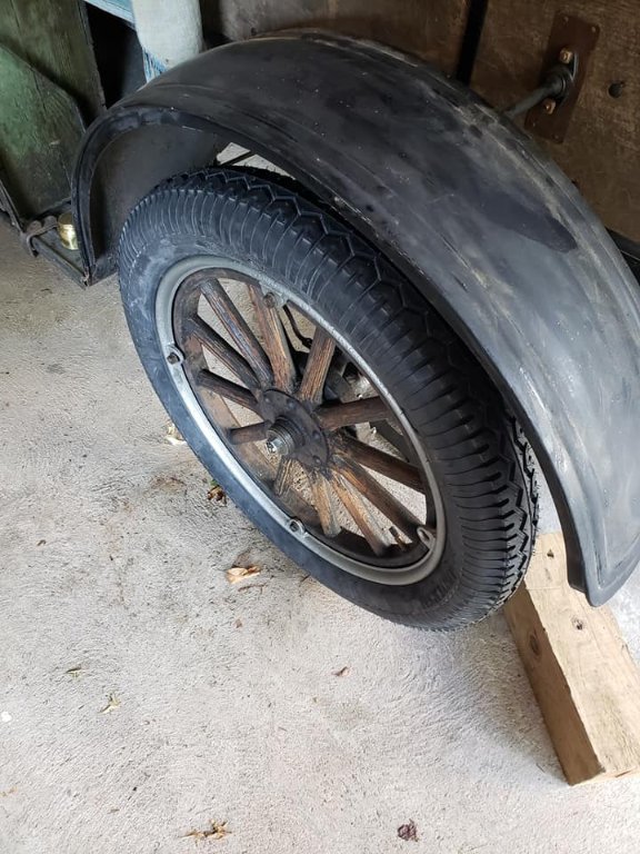

Front two tires mounted! Sure looks good. Hopefully our tubes hold!

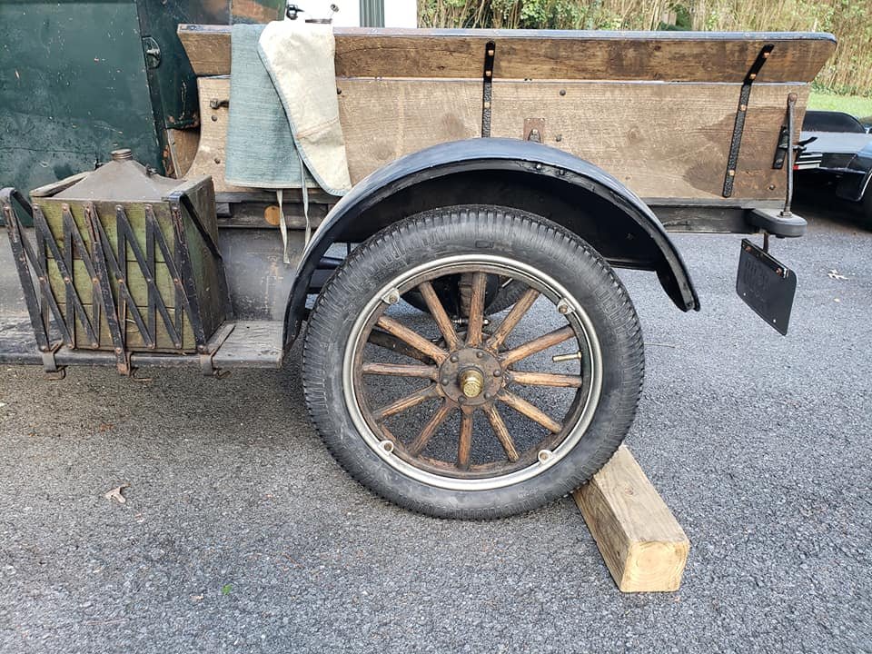

Rear tire mounted! I'm proud of my painted rims.. I think the color and sheen turned out good.

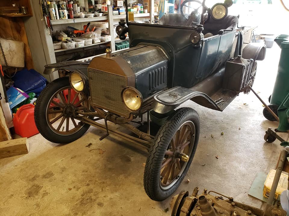

All four wheels.... ready to go!

Would you just look at that!
Sweet rubber tired perfection.... or imperfection that only a true patina can show.
Me and my T... let's go for a ride! Stay tuned!

Looks like both beads @ the same time. Right on. The V notches are fine for your metal stems. A bit light if using the rubber stem. Looks good.
