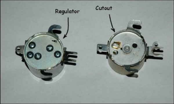

However, you say that you have "NEW" Fun Projects third brush plate and regulator cut-out - where/when did you get them. I don't see them for sale anywhere. Also t wouldn't hurt to verify that you have the regulator and not just a cut-out
