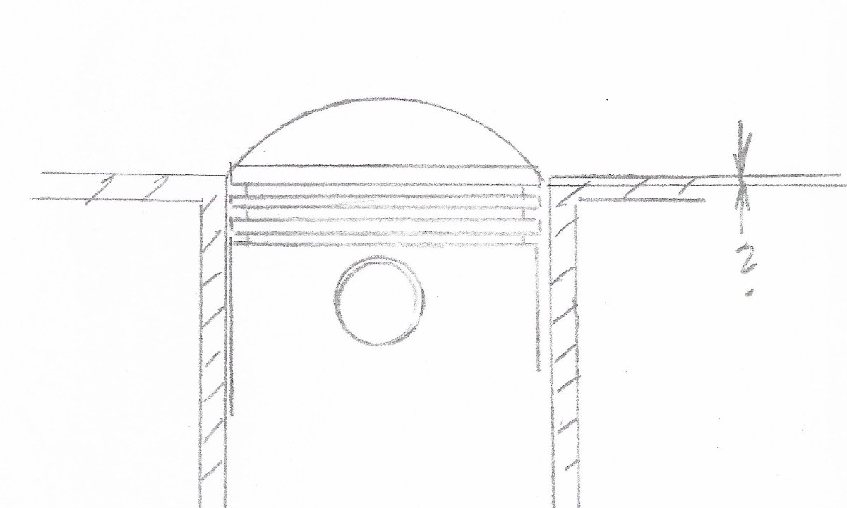

Working on a custom piston and was looking for suggestion on what is a recommended distance from the top of the top ring to the deck? Thanks

All modern automotive type pistons I've ever seen have around 3/8" above the top ring, probably to give some protection from heat and facilitate keeping some lube available to the ring. Reducing the dimension could improve efficiency, but would most likely place the top ring in a more stressful environment.

Thanks everyone for the help. The issue I'm facing is that the crank (Model B) has been stroked giving the engine a 4 5/8" stroke, so the new aluminum version of the model T piston will have the top ring pop out above the deck.
