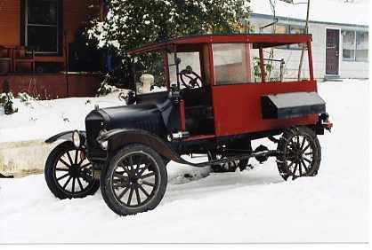

Post by Mark Gregush » Thu Sep 23, 2021 7:39 pm
Traction on the flat not bad, with chains better. :lol:
T in the snow.jpg (29.75 KiB) Viewed 5477 times
