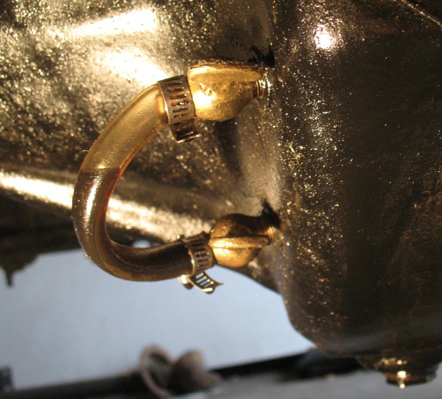

There are two problems with a sight glass that caused me to abandon mine. The actual problem was that it gave false readings. Sometimes in the dim light under the car it looked like it was full when it was actually empty. The potential problem is that if it's wrecked by some road hazard all your oil leaks out.

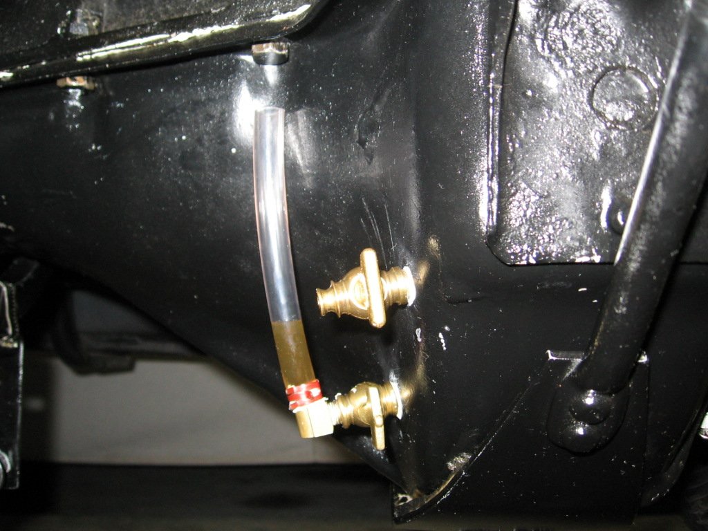

I prefer clear tubing. Open the petcocks to get your level, then close them so you don't lose your oil if anything happens to the tubing.

I was lucky enough to find a petcock on Ebay that had pipe threads on both ends, so I bought it and a right angle adapter so that I can open the petcock to check the oil level, then close it for driving. Works great!

As Steve says, the sight glasses can give a false reading, and I have had one fall to pieces. The Ac-U-ret dipsticks work well, but it can be difficult to locate the hole in the splash apron to suit the tube. The pan hole angle and the thread angle and the bend in the fitting to the pan all contribute to variations of the angle of the pipe. They are very convenient. My 27 Tudor I imported from the USA has a modern dipstick under the hood. Ideal if you are not fussed with originality, but easily reversed if you want to. Your choice.

A sight glass requires a little bit of extra discipline that many are unaware of. Follow the discipline, 99% of false readings go away.
Before starting with a desire to check...
1- Close petcock on transmission
2- Open drain on sight glass and it should drain in a cup or cap lid. If it doesn’t, poke the hole at the sight glass bottom
3- close the lower drain, and open the petcock between the tranny and sightglass. You should see the oil rise in the tube.
4- close the petcock from the tranny if height looks Ok
5- drive
I’ve done this for years, never had one break, but nothing can run out either if you follow the discipline. By the way...if it doesn’t run out the lower drain, or it seems to stall and start on refilling the glass tube...there is or should be an itty bitty hole at the top of the sight glass that may have caked over

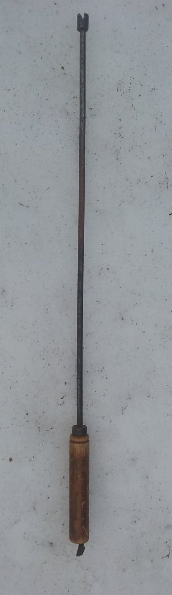

You can get down on your knee and near the right front tire, then reach under between the fender and tire with your left hand and turn the petcock. It is not necessary to crawl under to do this. Or you can, if you can fine one use a metal rod with a piece welded on the end to reach under and turn the petcock. In fact this tool has been in the past, been given out at large tours as a door prize. It wouldn't be too hard to make them and either sell or give them to members. Similar to giving the stick for measuring the gas.

Norm, I'd love to have one of those. I've been too lazy to make one, you can also reach in almost as easily with a big pair of pliers. The tool is the best !

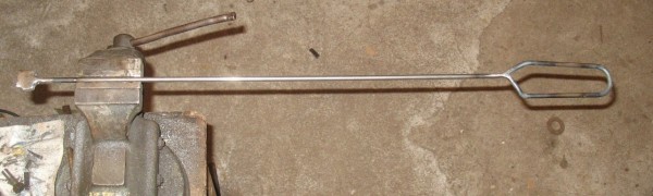

I've been using the oil checker rod similar to what Steve posted in all my cars. No brainer.

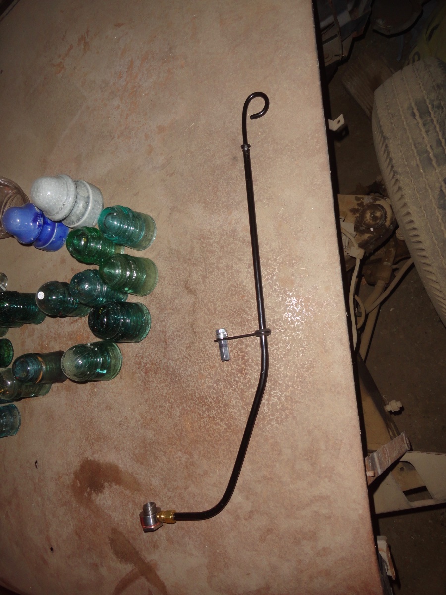

Ask, and ye shall receive ....
I have been watching this be developed over the last year, with various ideas tried
and refined. They finally went into production recently and I got one for my truck.
The idea is that the base piece replaces the oil pan drain plug. This allows a reading
of ALL the oil, not just what is above the lower petcock. A centered drain plug in the
Antique Auto Ranch unit allows normal oil changes without messing with the dipstick
tube assembly. The stiffener/stabilizer bracket midpoint up the tube attaches at the
hogshead, making it risid, and placing the dipstick at a very convenient location for easy
reads and re-insertion of the dipstick. A loop end was adopted, similar to a Model A unit,
which is super easy to use.
The genesis of this product was to find a way to achieve an actual oil level reading
all the way down to zero. Running minimal oil being a "speed secret" applied by the
Montana 500 racers, of which many of the AAR people and customers are actively involved
in each year.
I am quite pleased with the quality of the materials and having been party to the
design development, I can attest to these guys really thinking it through. And the
price is CHEAP !
Shameless plug for a great vendor in our hobby that doesn't get enough shameless
plugs: Antique Auto Ranch, Spokane, Wa. 509 . 535 . 7789

The repop Akuret (?) dipsticks were on backorder for a long time. I got one about a
year ago, but stalled on the installation, as stabilization of the tube is done by drilling
a hole in the running board splash shield. Since the TT doesn't have these, I was conjering
up a period-looking support arm when the AAR guys began fiddling with their design at our
Tuesday night meetings. So, that was as far as the Akuret install got.
The key advantage of the AAR unit is the positive reading all the way down to zero, and
the tube mounts solidly to the engine. The Akuret only reads oil levels above the lower
petcock and on any application without splash shields, will require something to hold the
tube, or it will want to sag, dropping the open end down and draining all the oil out above
the lower petcock. I prefer the period look of the Akuret castings ... I am big on appearance,
but the finctional advantage/s are too great to overrule. I will probably put a knurled knob
on mine to replace the loop to appease my aesthetic sensibility.
The Akuret sold for somehwere in the mid-fifty dollar range. The Antique Auto Ranch unit
will price right about the same, they told me. Give them a call and get it from the horse's
mouth ! 509 . 535 . 7789
