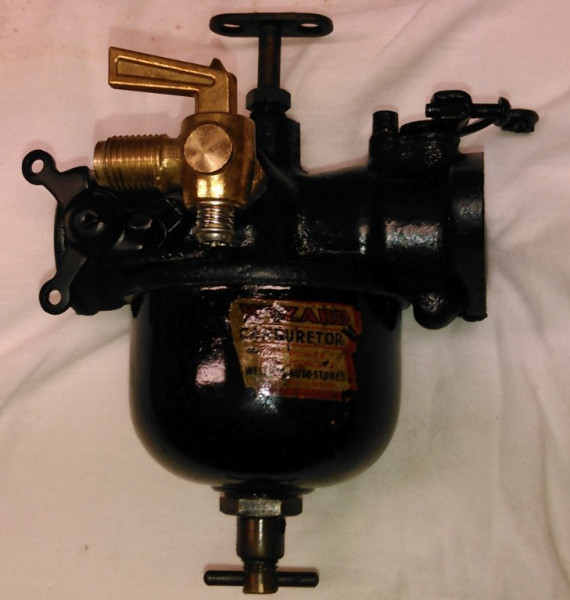

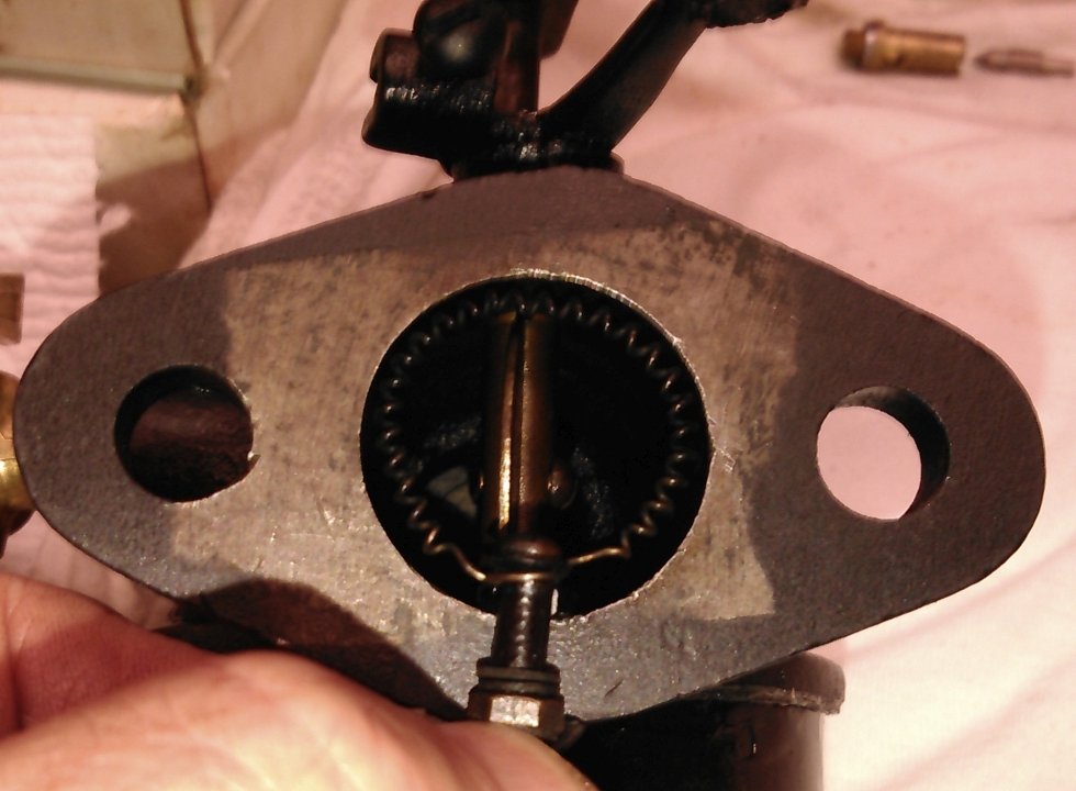

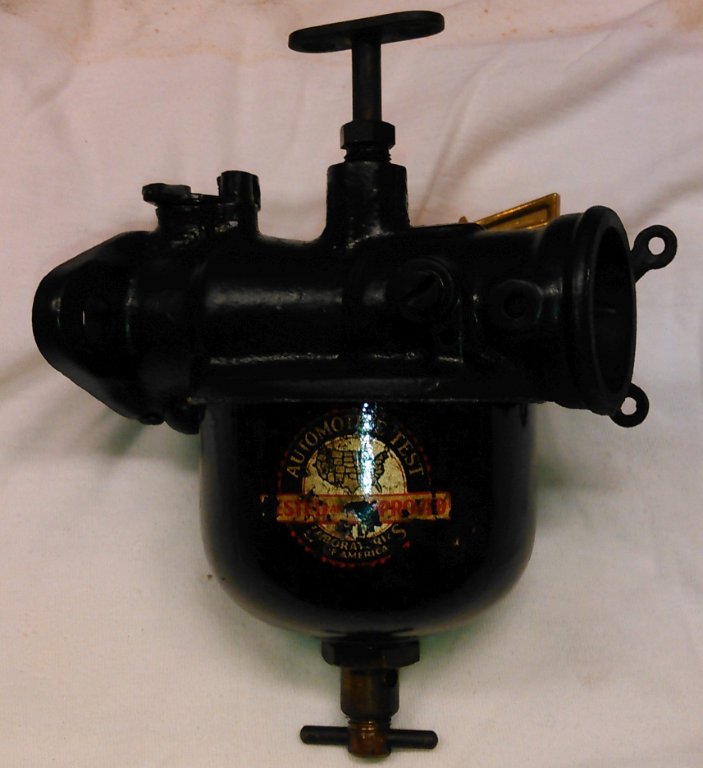

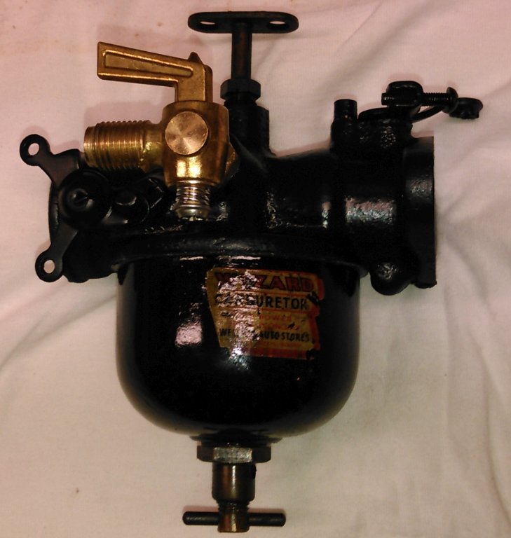

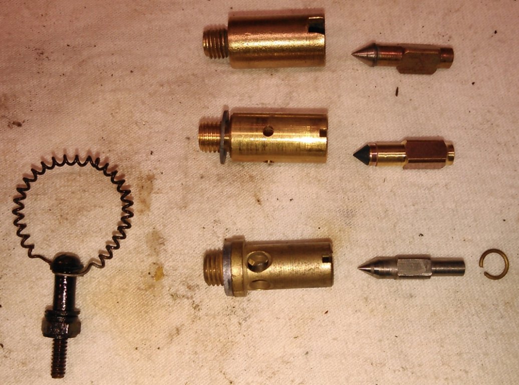

Here is a WIZARD carburetor, looks NOS. It was sold by WESTERN AUTO. I just got it cleaned up and ready to use. Though I would post some pictures of it. I removed the heater ring since I plan not using it. In the last picture I posted some float valves for comparison. The one on the top is a FORD one for a NH carburetor, the next one down is the one that Scott Conger makes for the NH carburetor, and the one on the bottom is the one out of the WIZARD carburetor.

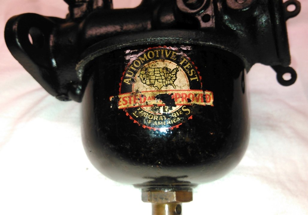

Interesting comparison !

Same as Simmons?

Yes, I believe Simmons made it for Western Auto from what I can tell.

The float valve that Scott Conger makes for the NH Carburetor fits in the Wizard Carburetor and works. Should be a good replacement part for it.

Many years ago I picked up a NOS simmons in Oregon. Has the same automotive test sticker on one side of the bowl & a simmons decal on the opposite side. No brass plate. I have another version in the cabinet with a brass tag like an NH, but says simmons. There is a third version called a duplex. All the same carb with the weighted flapper for the idle circuit. Nh needle/seat unit interchange. Jett & mixture needle are different to the NH.
