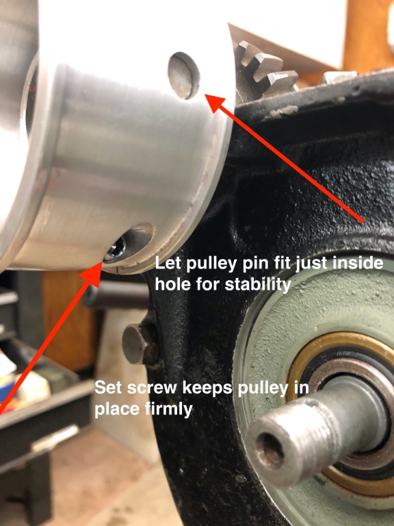

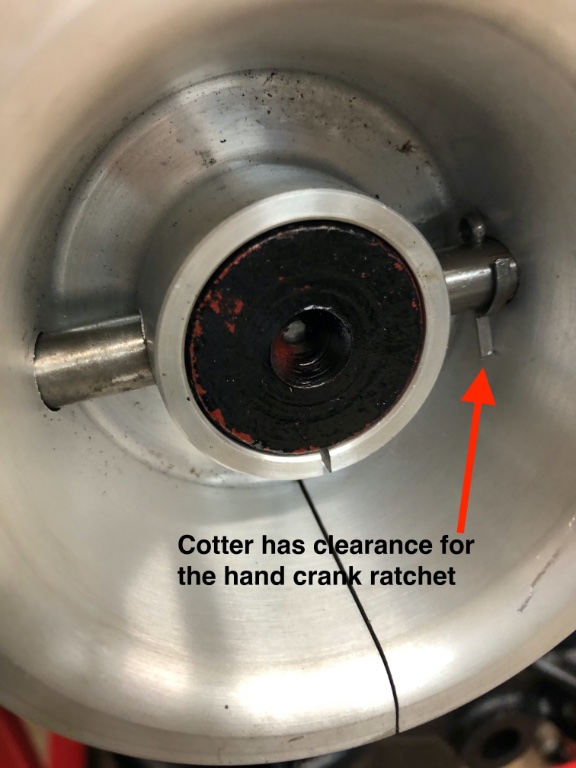

Those alum flanged pulleys are my choice over used Ford steel crank pulleys.
The set screw keeps the pulley firm on the crankshaft. But I'll not trust a hollow roll pin for the starting crank ratchet, so I use the Ford all steel pin.
Place the pin so a tiny part of the solid pin with the cotter hole just slightly engages the opposite hole in the pulley. Makes the pin fit so it can't bend on hard crank handle usage. The cotter is well clear of the starting crank ratchet, so there is clearance for that toothed ratchet. I always check to be sure of good cotter clearance when fitting the solid pin.
When you fit the pin, then clamp down the split flanged pulley with the set screw.....that tightens all, the pulley and the pin, nothing can move.
