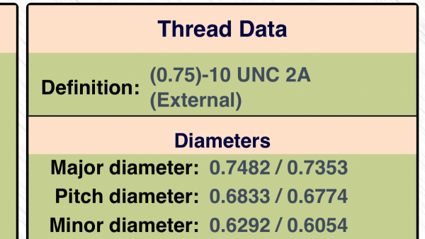

Working on my recently rescued 27 Tudor and got a very insect damaged driver rear wheel. Attempting to remove it has been fruitless and has resulted in the center bolt of the puller to bend and crack after 4 smacks with a 4 pounder. I was able to extract the bolt from the puller but the threads need to be chased and the bolt replaced. Thread gauge says it is 10 tpi but measures .730 across the threads. What the heck is that? Is that considered 3/4”? Hoping some machinist can set me straight

There is a tolerance connected to the major diameter of screw threads.
For a 3/4 10 external thread the max is .750 in.
The minimum diameter is .735 for a class 2 thread..
And .737 for a class 3 thread.
Often you will find that the major diameter is below the minimum, particularly with economy applications.
Art Mirtes
Art Mirtes

.730 diameter sounds believable for a 100 year old machine screw thread. Most of these parts were produced when the National thread standards were in their infancy... so not surprised when profiles and dimensions are slightly off our modern standards
