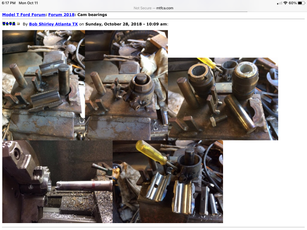

Your best method is to make a new shell with fresh iron & split as originally done. Babbit is not necessary. Early T cam bearings had no babbit & were higher H/P motors. When decent bearings were not available, this is what I did. The high cost & questionable quality of replacement bearings makes this a feasible/worthwhile project. Contact me with a # if you want to discuss.

IF the split still locks tight & IF the OD is still good, that's an option.
The bearing halfs can be tin plated. Not sure if that would damage the split fit, but that would add some to the OD and a base for the babbit to stick.
