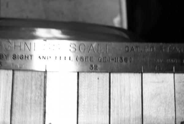

For what it is worth, Dan Hatch, I am firmly convinced that Ford got away with the claimed super close tolerance they used for 3 reasons only and one of them was that they DID use sizing balls from some point in annual production as early as the end of the brass era. How do I know this (and why I have trouble with traction on the claim) is that I bought the technical library section on Ford that was in the former Humber Motor Car UK library and in the apparent technical exchange section between Ford and Humber there are talks about bronze pushback at various speeds and feeds and using trial and error methods until needed size is achieved. That doesn't confirm a ball sizing, but no one has ever tried explaining to me how those words can apply otherwise! I also would, at the design interference and there being bronze, there was probably also an insert tool used before the ball. Just a guess on my part...but enough to convince me that is how Ford must have done it to achieve what they did. (It's a shame Ralphie went and died on me before we were done and I'll admit that I lost interest in bringing the blind test full circle with conclusions.)
For others,
I have always suspected that super polishing is not the best way to go and there should be a bit of surface finish difference between the pin and the bush. When RDR and I did the blind test involving 100's of pin sets we had about half that were made of the right metallurgy (ergo Ford made) and none of them were better than a 32 finish....Further,for my 2 cents at the 0.004" total clearance, the reality of the situation is that finish actually is pretty much out of the equation.

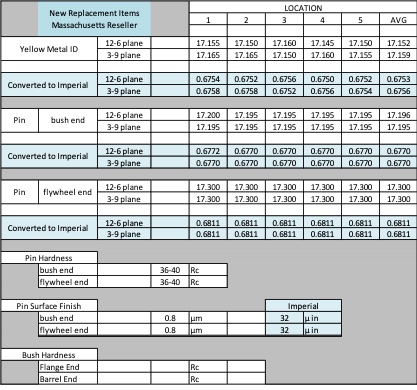

Here is something some may find interesting, others will go 'ehh'. This was from the work Ralphie and I were doing, never made it to publish...
APPENDIX # 1 New replacement Pins and Bushes
As an adjunct to the forensics testing done on the used NOS and used NORS pins and bushes in the blind test organized by Ralph Ricks, it was decided to buy a set of new pins and new replacement bushes and perform full QC testing on the as received in order to have a modern comparison. Only one bush and one pin were tested this way.
The vendor is ‘nameless’ however the pins were bought in 2012 and the new replacement pin is the type having grinding centers and the ‘step’ in the pin diameter with the larger flywheel end. There is no rim as on original pins. The bush is the type with a spiral oil groove with ends broken through, that does not match the original Ford drawings on groove specification.
The testing was done at one of Chi-com highest level tier #1 test centers certified to do direct testing for Ford Motor Company, TRW, Mercedes and Brembo in a standard format to the third decimal place, metric.
The results are shown as Figure #1
Conclusion-
• The pin inspected is as near perfect and flawless as possible to basic dimensions. The pin is manufactured to the lower limit (bush end) specified on drawings for the T-3315, factory number 715 pin on original Ford drawings, however that is not a bad thing.
• Run-out and coplanar (out-of-round) tolerances were not checked as a sample of 1. However, due to the way the grinding centers were made and the 4th decimal place (Imperial measure) absolute control ‘to size’ in planes 90 degrees apart, these pins are at least as accurate, if not more, than original pins made by Ford.
• The hardness although shown 36-40 is the lab way of bracketing hardness reporting when slice and dice photo micro-sectioning is NOT performed. Nominal is Rc 38 which needs to be compared to the original NOS and NORS forensics when completed.
• The surface finish is 32 on both the flywheel end and the bushing end. 32 is definitely correct for the press fit into the flywheel and some may question the 32 for the bush end as being too rough and further shoe shine of the surface would be required for a bush to self-hone.
o The reporter holds that 32 is probably the finish that Ford originally intended in spite of lore that micro-lapping to get ‘wrist pin’ smoothness was the way to go. The report in the forensics of NOS & NORS will explain why the author believes the 32 probable.
o The vendor has been asked to inform their supplier that shipping pins built to this precision open and loose in bags of 3, or shipped in boxes without sleeves from the maker causes small bumps and nicks, some almost microscopic however a simple care in handling, storage and shipping would allow these pins to be used with no further attention to detail once received.
• Since these are the 2 diameter pin a calculation was performed which shows the flywheel end to be EXACTLY 0.0041” bigger than the bush end and this value, when using this maker’s pins needs consideration when determining the press fit into the flywheel.
• The bush was sent out for metallurgical content and grain size analysis and will be reported on in a further supplement.
Conclusion-

lots of good stuff in your research. I will second the vote on surface finish. Any study at all of mechanical/lubricated components relating to bearing surface finish on plain bearings will support your conclusion. Oil films do not like polished surfaces, and when running, with proper clearances, the metals are not touching other other than at start up and shut down. That said, 32Ra finish can be made a number of ways, and anyone that has used a Taly Surf to measure finish will be surprised the first few times, just how different parts can look and still measure the same finish, if certain defects and deviations happen to be missed during measurement. Bottom line, a turned surface at 32Ra can sometimes be problematic, whereas a ground or honed finish at 32Ra will be very consistent part after part.

Adam, you are absolutely correct that Ford found a way to make the running clearance 0.002 as per the prints...yet point of fact, anyone who has tried since with even modern ideas and production practices has transmissions that have a bad habit of swallowing themselves in the first 200 miles. Sort of like modern FoMoCo Gear research used on the T1000 to supposedly take away howl and also survive a hundred miles a day, everyday...those modern process gears lasted all of a couple of months!
Scott...good point on surface finish

Herm - I'm not that much of a machinist, and certainly not an engineer, but in reading this whole thread, it sounds to me like besides making certain that replacement pins are the right diameter, it sounds as if the surface finish of the replacement pins is also much more important than one might realize!

HaroldRJr wrote: ↑Sat Mar 23, 2019 4:27 pmHerm - I'm not that much of a machinist, and certainly not an engineer, but in reading this whole thread, it sounds to me like besides making certain that replacement pins are the right diameter, it sounds as if the surface finish of the replacement pins is also much more important than one might realize!
Yup!
