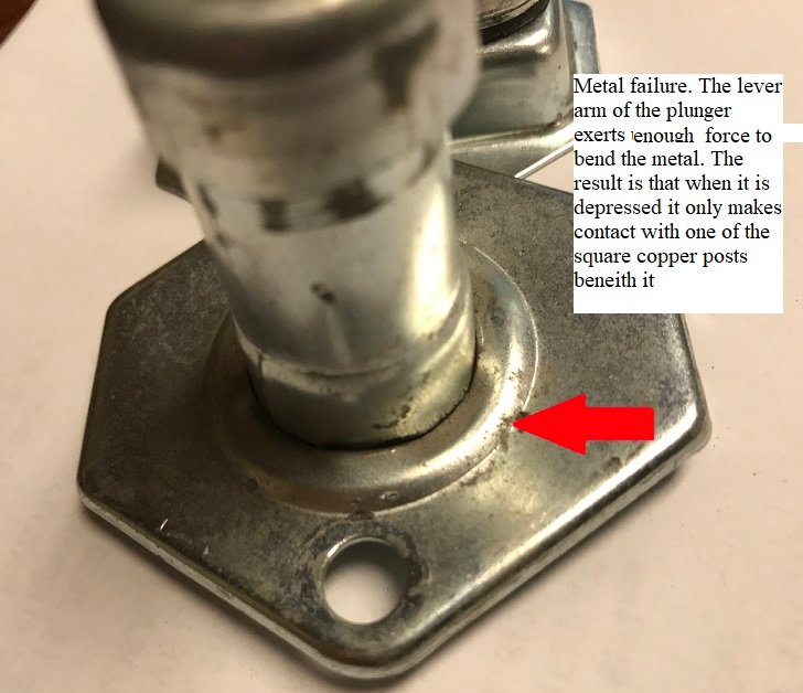

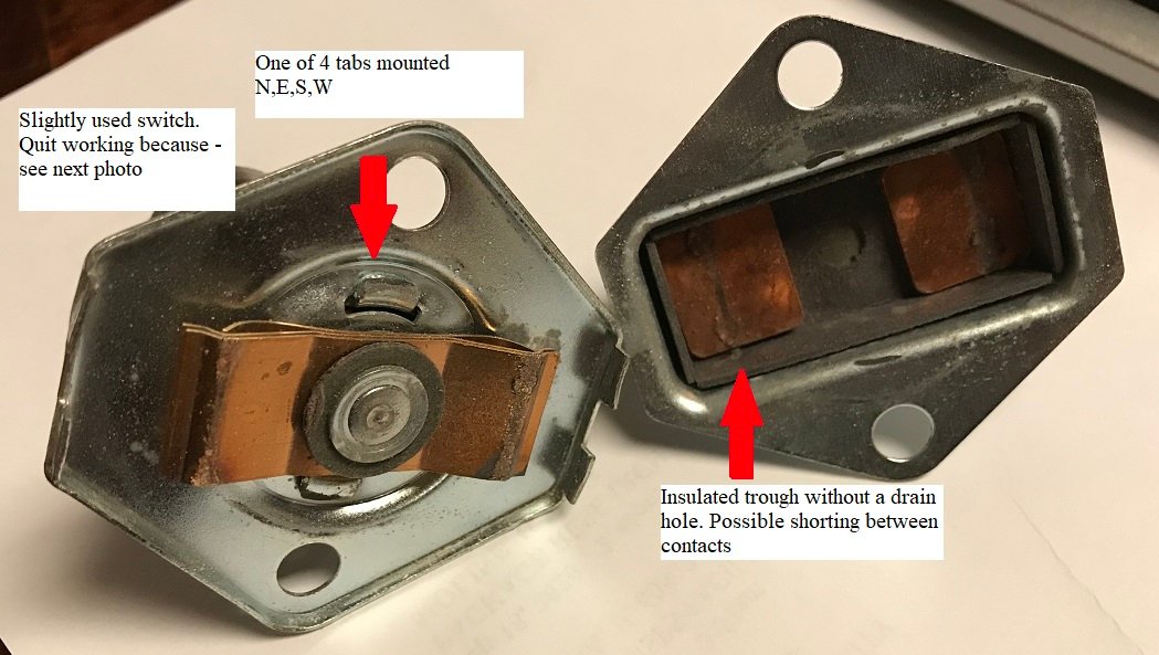

The issue with the reproduction starter switches has been discussed several time. Your observation of wiggling the switch to make it work is why it fails and then necessary to make it work. If the switch looks like the photos the problem has to do with how the plunger sleeve is attached to the base plate . Any rocking motion will cause it to loosen around the bent tabs at its base. Personally, I prefer push button & starter solenoid but if you need to be "original" then the only option is an refurbished original
