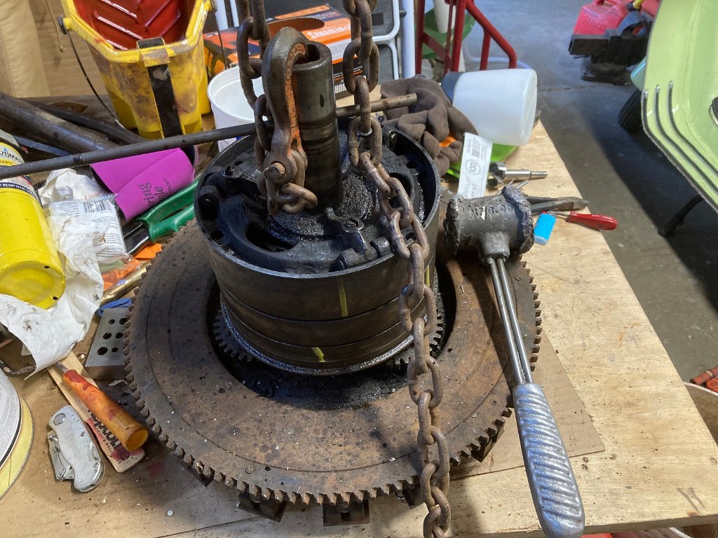

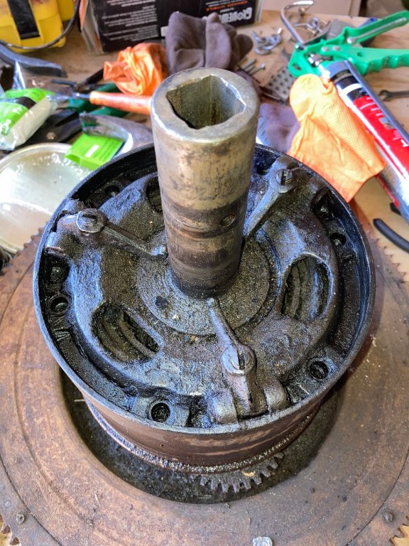

Bought this transmission hoping that some of gears might be good for my transmission rebuild this winter, I've been soaking this in Kroil penetrating oil, scrapping out the gunk, poking, prying and beating on this thing for the last month and can not get this thing to budge, the old burnt oil in there looks and feels like carbon when I scrap off what I can.
Looking for any ideas how to get the driven plate off, at least that's what I think its called.

Try hanging the tramission from the tail shaft driven plate a few inches off the floor to let the transmission weight help separate the parts. Try to hang it as evenly as you can so the pull is along the transmission center line.

Manually scrape away the crud inside the drum down to the plate. Grab the drum with a strap wrench & rotate the drive plate. Screwdriver between finger & shaft or square output drive.

I can only think that that drive plate is hung up on the bushing that rides on the end of the transmission shaft. A heavy drift through the centre of the drive plate shaft will pound the plug down so that pressure can be applied to the trans shaft. Or, I may have missed something.

though it cannot be seen, there is a bronze bushing in the front of the output shaft which rides on the transmission output shaft. I believe that this is what is keeping your shaft from coming of. While I am not looking at one now, working from memory, there should be two holes in the side of the tail shaft in which you should be able to flood some penetrating oil which would work into that bearing and release the crud.
Hanging the assembly off of the floor by an inch or so, with plywood under it and exercising patience should eventually see the thing come apart. If you are impatient, the suggestion of heat should finish the job.

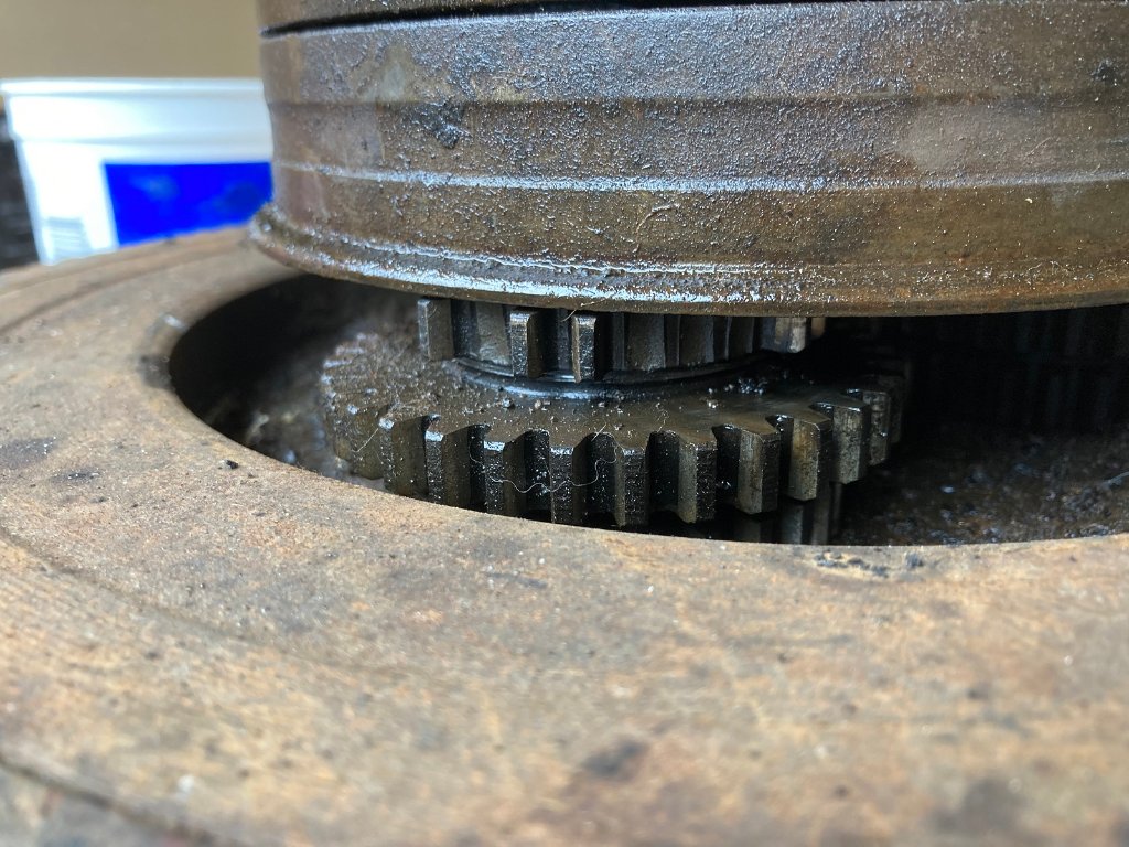

I hung this from the rafters and beat the crap out of it for 20 minutes and it finally cam off, I was dismayed to fine some teeth missing on the triple gear

I learned a good while ago to not ‘force’ anything on these old transmissions. Hope you didn’t break anything. When pulling straight up and letting the weight pull down on the assembly the triple gears get cocked ever so slightly enough to grasp the triple gear pins. I cracked a good drum on mine using to much force. Learned not to do it that way again.
