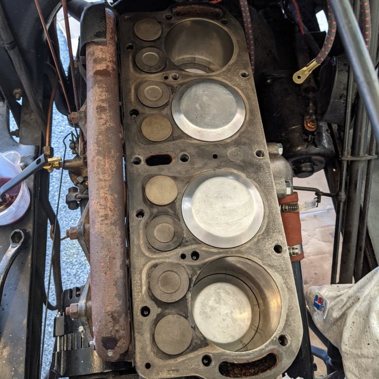

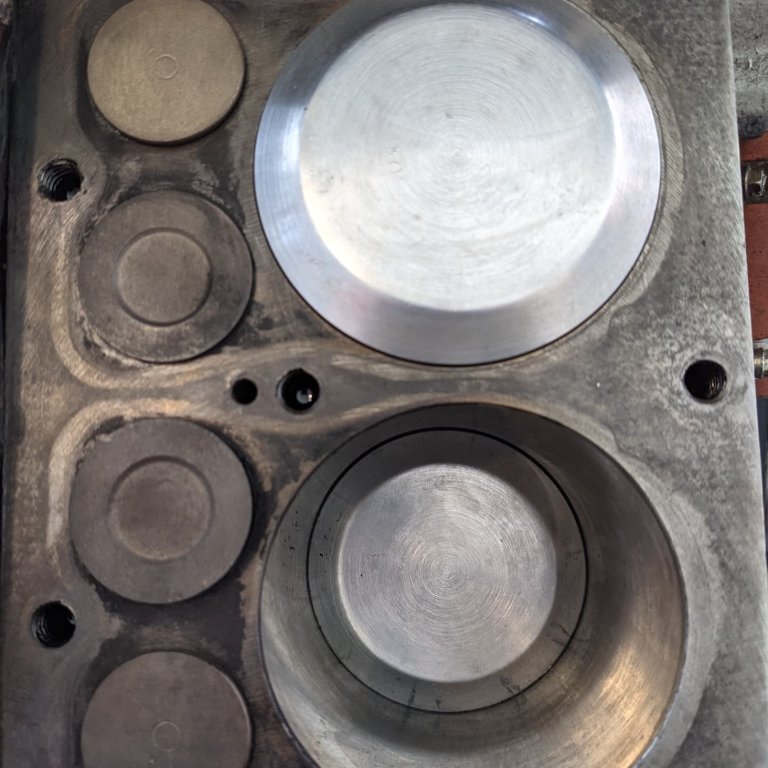

Cleaned up the engine to get ready for my Z head. Does everything look okay? I've never had my engine's head off before. Looks like some overhauled the engine at least before I got it.
Posts: 4501
Re: Look normal?
Post by Jerry VanOoteghem » Sun Oct 10, 2021 7:20 pm
Looks like new pistons in old bores. By "old bores", I mean they do not look freshly honed as you would expect to see with new pistons. Do they look like new because you cleaned them up so well, or did they look like this when you removed the head? Have you ever run this engine?

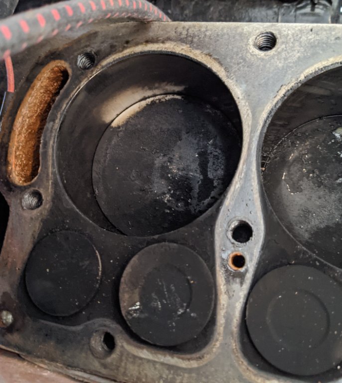

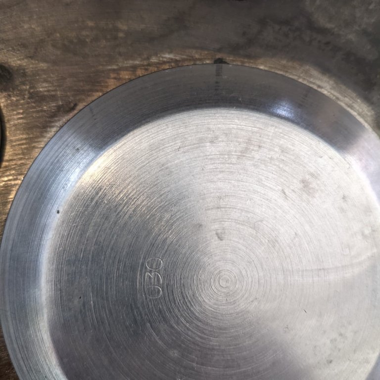

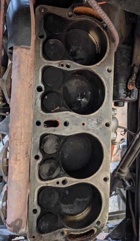

Yea, I've ran this engine as long as I've had the T, about 7 months. Here's some pics of what it looked like when I took the head off.

You also have replacement one piece valves, so someone has definitely been in there before you. It looks good to go.
