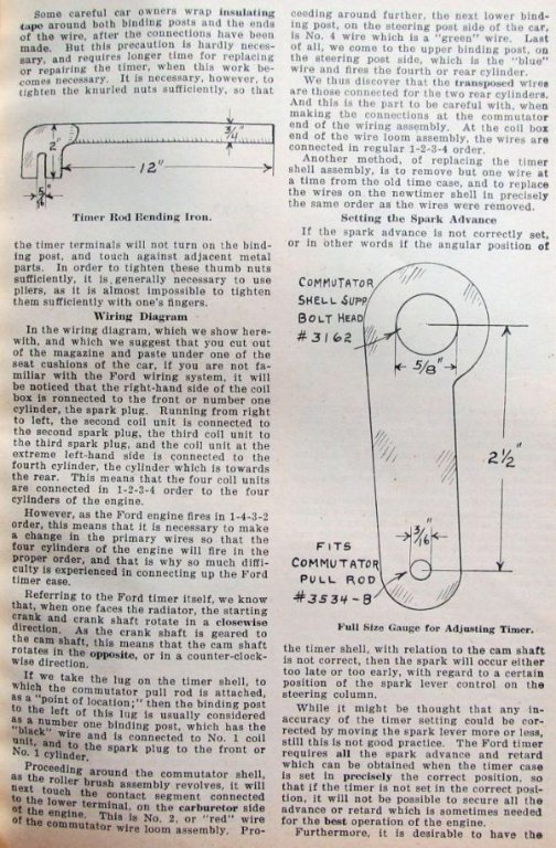

What are the measurements for a timer adjustment made from scrap aluminum? Need center to center distance and diameter of holes.

be aware that this timer gauge is good for ONLY original Ford timers and CANNOT be trusted to set up any other timer accurately.

What should the center to center distance be when using a New Day type timer on a stock engine? I used 2 1/2" and it did not work well.

You cannot reliably set the timing of a non Ford commutator and a non Ford roller by measuring the distance from a bolt to the commutator rod. There is no shortcut. You must use the piston position to determine actual TDC. If the fully retarded spark lever position allows a spark to fire prior to TDC you have a dangerous situation which may cause the engine to momentarily run backwards during a start, potentially resulting in a broken arm while hand cranking or a damaged bendix when using the electric starter.
To determine TDC, remove a spark plug, insert a long wire into the cylinder, slowly hand crank and watch the wire go up and down, when it reaches the maximum exposed length, you are at TDC, when the wire starts to get shorter you are at past TDC. I set my timer for just past TDC. The piston will have two TDC cycles in a 4 cycle engine, you will want to be at the end of the compression cycle/start of power cycle when doing the test.

Not to gainsay excellent advice, I wonder if some after-market timers present the same as the stock roller timer ? Years ago, I set up a New Day on the 2-2/2" measurement in ignorance of an actual TDC check with good results. My current Lizzie runs a TW timer which I also set up by measurement, then thanks to this forum, checked via TDC, also correct. Good to know these things !!

In regards to the new day. The problem is the clocking of the brush, depending on the one you have. Its safer, surer & more accurate to check with the crank pin location. No tooling required. This method works with all timers & distributors.Rich Bingham wrote: ↑Fri Oct 08, 2021 1:37 pmNot to gainsay excellent advice, I wonder if some after-market timers present the same as the stock roller timer ? Years ago, I set up a New Day on the 2-2/2" measurement in ignorance of an actual TDC check with good results. My current Lizzie runs a TW timer which I also set up by measurement, then thanks to this forum, checked via TDC, also correct. Good to know these things !!
