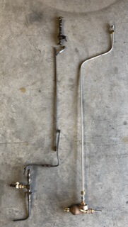

This ‘25 Coupe had a total restoration 20 years ago. I have no idea what they were thinking. Getting the Carburetor off to clean out was a huge PIA. I will be replacing with a regular potato and one piece line. Enjoy!

The problem is that someone started at the tank and made all the runs and 90° bends to the carburetor not taking into consideration the carburetor would ever have to be taken off in the future. It is very stiff and precise but with no “Union” in the line.

The two near the carburetor actually have threads on the back sides and tighten up as you try to unthread them. I’ve never seen this type of fittings before.

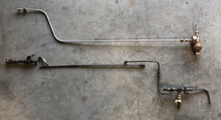

Dismantled the “improved” gas line someone installed 21 years ago and went back to original. 26 parts back to 6 parts! 😊
