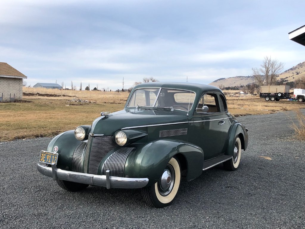

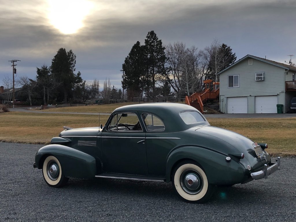

I mounted radials with special tubes for radial tires to my '39 Caddie and it transformed to car to make it much more drivable. Steering, traction & braking were all a lot better. This car will go very fast, it just cruises easily at 70 mph so the improvement is wonderful. The Caddie is no Model T, I'm not sure how it would improve a Ford's baby.

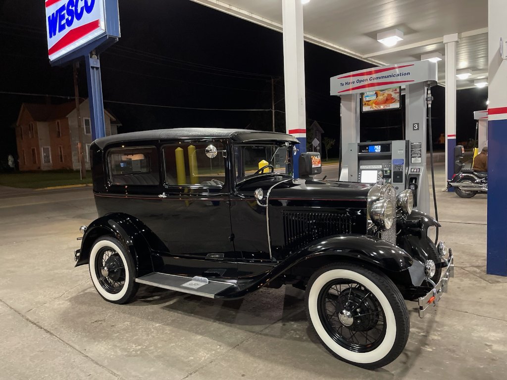

I bought a set of the new tubed Whitewall radials for my 1930 Model A and they made the car drive a lot more like a modern car...as in safer and better handling. I did notice that I have to keep them at 35 psi or they will feel kind of squishy even at 32 psi. The tires I have all say MADE IN USA on them. Make sure you get tubes that are made for radial tires.

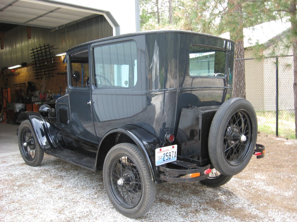

I have a set of the radials on my 1927 Tudor they handle very good.One thing I have noticed the circumference is 4 inches more than the Lucas that I had on which affects the hill climbing.
