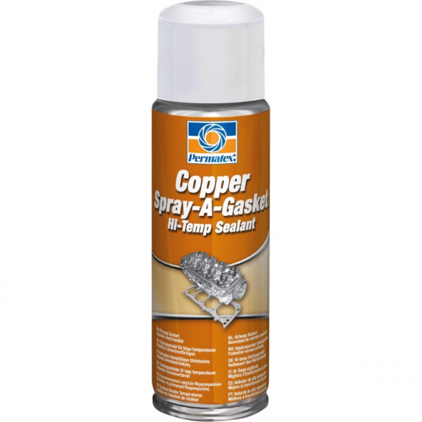

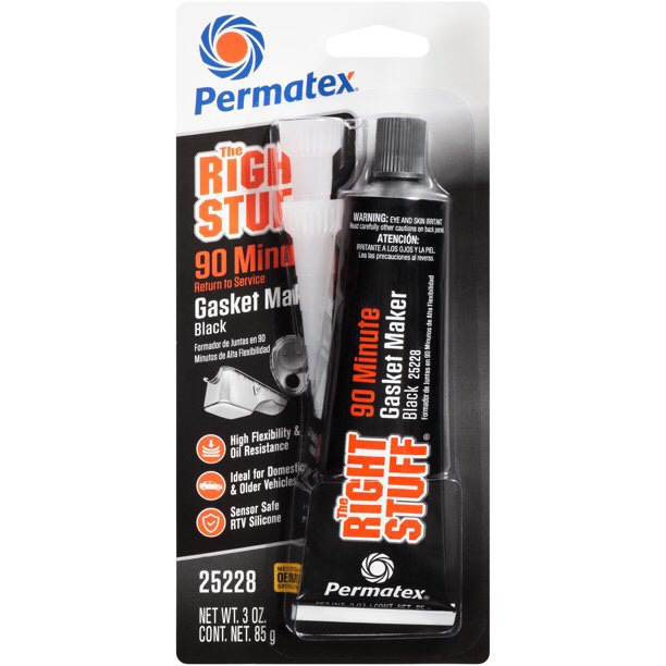

Over many years, the bolts and nuts holding pressed steel flanges to cast iron part have been over tightened, causing the pressed steel flanges to distort, such as the oil pan and transmission cover, valve cover, bottom oil pan cover and bendix cover. This results in the holes fitting tightly against eachother while the areas between the holes are like shallow ditches that a gasket cannot completely seal. If you do not have your pan trued up on a pan jig, you will need sealant to seal the flanges between the holes. Even with a trued pan, sealant is a good idea in case you overtighten the bolts and nuts and recreate the conditions mentioned above.

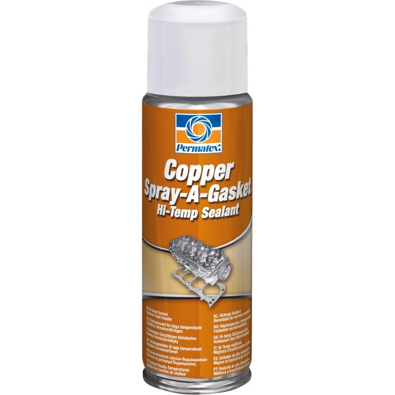

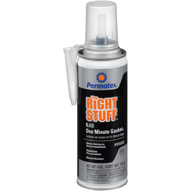

I’m one of those that prefers “The Right Stuff”. I just feel it is the best. I’m not fast… as a matter of fact, I am verrrryyyy slow and methodical, but I discovered that doing one side of each gasket at a time and bolting it tight against the opposing dry flange (protected by wax paper) and allowing the one side to cure overnight before unbolting and doing the other side, gets around the problem of the sealant curing before the application and aligning process is completed. Also, the one dry side with wax paper allows you to easily slide the one side around to quickly align it without distorting, wrinkling, folding up or ripping the delicate gasket as often happens when both sides are slathered with sealant. When done, I get an almost perfect, leak free seal. I use the “Permatex”spray-on copper seal for both sides of the head gasket. Several have mentioned that they do not apply sealant to the machined side which is okay, if the surface was just resurfaced, but one does not always choose to have their block resurfaced and I have never heard of anyone resurfacing the underside surfaces if the block of hogshead where it meets the pan. I believe it is always a good idea to do both sides of all gaskets, even if the one surface is machined because as old as the Model T is, even a machined surface is often pock marked with rust pits which, if not sealed, can eventually be an avenue of escape for oil or, water, in the case of the block and head. Jim Patrick
PS. Also pictured is also is 90 Minute “Right Stuff”…
