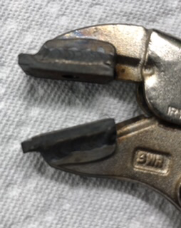

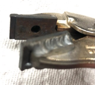

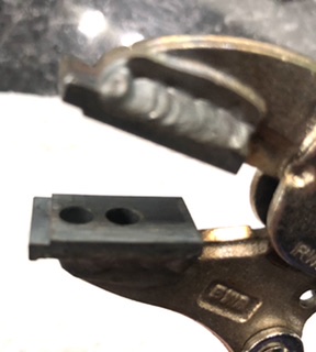

I actually have one of the John Regan tools in a bag of old points and had forgotten it’s use.
What does this tool do? Also in the bag of old points…

Michael . ......that tool was made to properly set the limiting rivet on the upper point assembly

Michael
points were notorious for having either too-large of a cushion spring/rivet gap, or outright loose rivets
those pliers were Ron Patterson's creation and were intended (once adjusted correctly) to press the rivet to the correct working length and then spread the center-peened end to keep it in place. I used to use mine to do the first part...set the rivet length and then I used my watchmaker's staking tool to finish the job. There were at least 20 from his first run of tools...I don't know if he did more or not. They were clever and I liked mine. Not a mandatory tool to use, but if you're doing a lot of the same work repetitively, they were handy and I'm happy to have mine though it doesn't get as much use as it used to.
