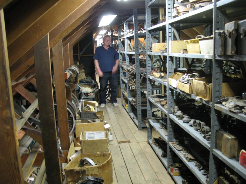

Glen with some of the original parts at Chaffin's Garage.
