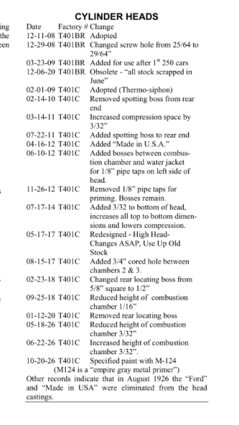

Re: Intresting question on Facebook about high head with no Ford USA
According to Bruce’s research, combustion area of Non-script high heads are the same as all the other script high heads made after 9/25/18, except for about 1 month (of script heads) in ‘26 when the compression was raised then lowered again. You have to cc a head to know for sure, but odds are fairly slim to run into one unless the production date of your car falls in that range and it still has its original head.speedytinc wrote: ↑Sat Oct 30, 2021 11:56 amDidnt the late heads come unmarked as you describe.(26-7)? They are of the lowest compression because of the worsening gas quality. These unmarked heads are found on vaporizer motors. I see them frequently. No reason to bother with em. Hope Im not bursting your bubble.
Here is the correct info:
Thanks Adam. Looks like the change only was in place for a few weeks. A very slight increase in compression, then back to same.

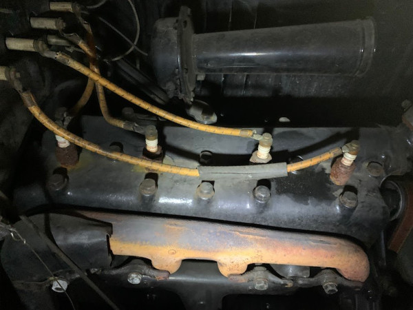

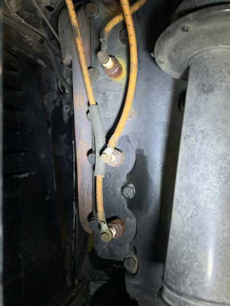

Here is a picture of the head that I have been running for years

Thanks for the pix Joe. Are you sure it is an uncut virgin? This new info has rocked my religion.
I had to mill it to clean it up and address for the bigger intake valves and 280 cam, valves touched side of head.
