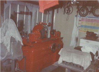

OK. I seldom involve myself in these sorts of discussions as every individual I have ever talked to who has done this sort of work has his own methods. I will, however, toss in a couple of pennies this time.
" When the necessary time has been taken doing this step to be within a tenth....."
Please explain how you do this when the center main is either badly worn or wiped out.
My machine is a Storm Vulcan No. 15. I absolutely agree that straightening the crank is a vital step before grinding, but I am not so sure that working to "tenths" during the straightening process isn't overkill. After all, these engines are not going to run 8,000 to 10,000 rpms at Daytona.
As Richard stated above, establishing an accurate center at the rear flange may be accomplished by steady resting the flange in a lathe and then recutting the 60 degree included angle with a single point tool. Dial-in the gear shoulder on the snout with a 4-jaw chuck. BTDT. This does not happen very often but it does crop up occasionally. These Model T parts have been in use for many years and some have been badly mishandled by would-be mechanics (the bigger hammer crowd) in the past.
Grinding a Model T crank is unlike any other in my experience other than a one cylinder stinkpot engine or two. Most other cranks are somewhat rigid. The T has a degree of flexibility you don't encounter with Model A or Model B cranks and certainly not with modern heavy crankshafts. Don't take my word for it; do the experiment yourself. Set up the crankshaft between centers and dial-in the center main with the indicator set at "0". Now give it a push with your thumb and tell me how much you deflected it.
Depending on your make of machine, some inward pressure, end-to-end, is exerted in the setup, not to mention the pressure exerted by the steady rest. It's not much, but remember we are doing a very delicate operation on a flexible workpiece in a very heavy machine. Imagine what that does to the crankshaft when it is in position. I was a bit skeptical about this phenomenon when an old timer (who had ground many T crankshafts on this machine) told me about it. Well, he was dead-nuts on about that! Your machine probably has a taper adjustment capability on the front table. You will probably find it necessary to use it while grinding a Model T crankshaft.
Further crankshaft grinding discussion might also include use of proper coolant, proper dressing of the grinding wheel (paying particular attention to the radius on each side of the wheel) etc. etc. This is enough for now. The instruction manuals accompanying the machines cover these subjects very well.
For those who want to discuss alignment of the transmission shaft vis. the crank flange, we can do that later. Wes Clover and I spent a considerable amount of time back in the '80's fooling with this and we found that an often-overlooked, seemingly-benign part (or two) would throw things out even when crank flange and transmission shaft were as true as we could achieve. It was a fascinating couple of days......and somewhat frustrating at the same time.
JMHO
JMHO

My question was aimed at what to do when there is no good indicating surface left due to extreme wear or a wipeout of the center journal.
The steady rest remains on the center main (which is ground first) throughout the rest of the grinding of the main journals. A second steady rest is used on the front or rear whichever is being ground at the time. The idea here is to make the shaft as rigid as can be when it is being ground to eliminate the potential chatter problem which can (and will) occur if the setup is loose. This "bow" is what causes the rear main (and to a lesser extent the front main) to achieve a bit of a taper as it is ground. That's where the taper adjustment feature comes into play.
Taking a "kiss" on the rear of the flange usually trues it up if it is found to be out. This is done between centers on a lathe after the grinding has been accomplished, and it is necessary if one expects to achieve a fair degree of accuracy in aligning the transmission shaft. If it requires more than that, the shaft has been forcibly bent and Brent is right in that it is not worth the time to correct it.
The T crank presents problems not usually encountered in grinding modern (or larger, stiffer) crankshafts. If one has not encountered one of these things before, the first grinding episode can be a real eye opener. I think it is a good idea to realize, as well, that we are dealing with job-shop type equipment which must be somewhat versatile simply due to the nature of the various jobs it will be called on to do. This is not the same as a production machine which does the same job over and over and over and over, ad infinitum.
