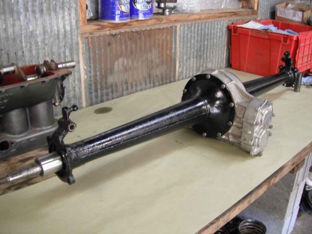

Hey Rob, crazy idea maybe, but for experimentation purposes you could fit a Model A Banjo rear with a Halibrand Quick-change....
It would make finding the right ratio for the Special a lot easier, and when the right ratio is found the Halibrand will be a quick sell.
It would require some 'light' fabrication to fit the rear spring and the torque tube, but hey, that's whats part of the fun right??

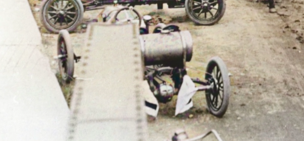

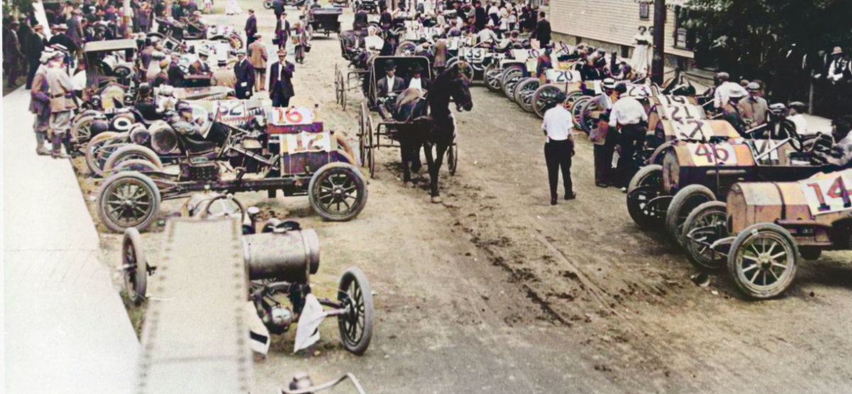

I wish I knew what ratio Ford used when they ran the big racer 109 mph. I know when it beat the Blitzen Benz (fastest car in the world at the time, including 1 mile circular track record) in the one mile timed race the Ford averaged 72 mph from a standing start.
At Algonquin hill climb in 1912 the big racer had 2:1 gears and averaged 65 mph from a flying start. Below is what the pumpkin looked like on the big racer in 1911, when it had 1.5:1 gears:

The A Banjo/Halibrand combo is not meant as a permanent instalation, just to experiment with ratios, once ratios are worked out just replace with your Special's own rear end (with appropriate ratio Crown and Pinion fitted) and sell the Hallibrand to the first Hotrodder to bid good money for it

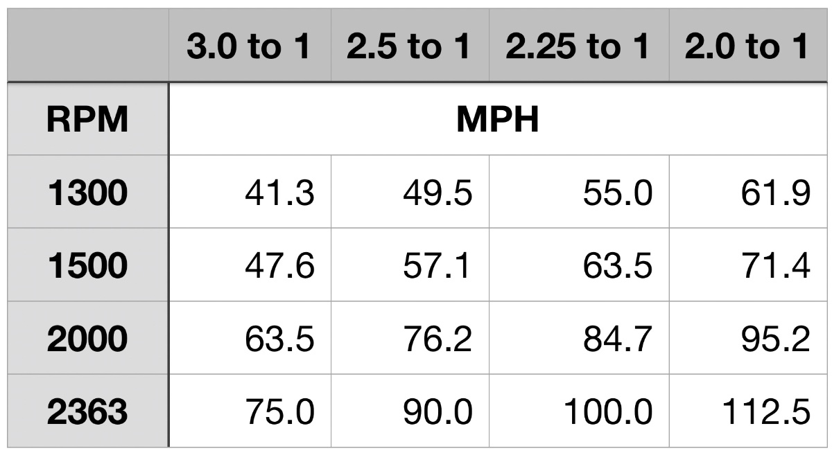

Comparison of 3, 2.5, 2.25 and 2.0 ratio to rpm comparison. I used the top end of 2363 rpm just because that's what it would take to reach 100 mph with a 2.25:1 diff:
