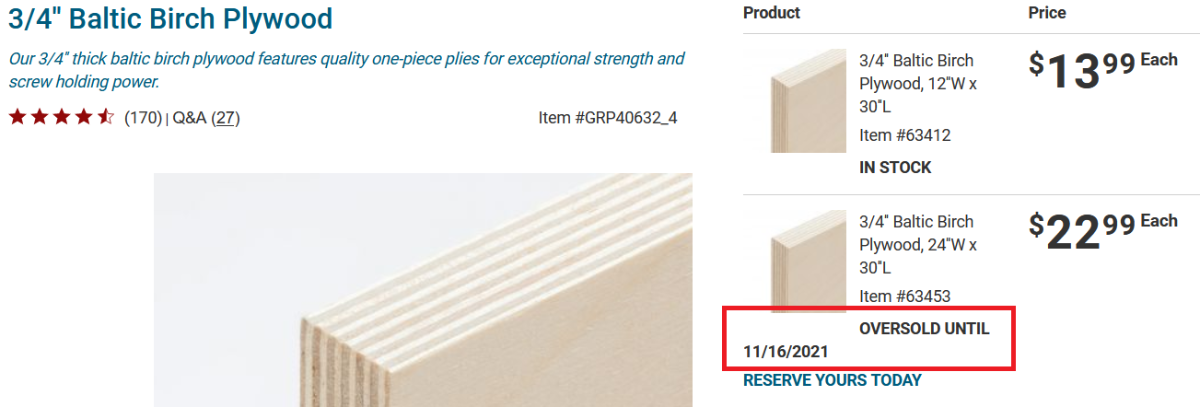

- Posts: 6545
Re: 1915 Firewall drawing?
Need to confirm actual thickness and dimensions (Rockler)
