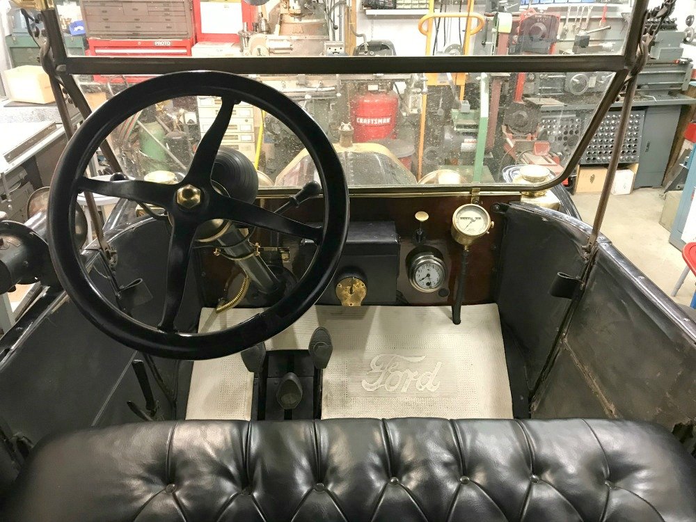

One thing I find fascinating, and fun with the ongoing repairs, restorations and upgrades, is trying to put my car back to as "period correct" as reasonably possible. My 1913 Canadian touring was built in September/October 1912. It has quite a few 1912 features. B-872 engine, steering column, front fenders, all lights, running boards, spring shackles are just some of the components Ford of Canada was using up when they built my car.
I'm now wondering about the coil box. Currently, it's a typical 1913-1914 metal box with the Canadian ID plate. The more I read, the more I think it should have had a wood coil box originally.
Would my car have originally had a wood coil box? If it should, I'm thinking that the KW replica the vendors sell would be the best choice. This way I can use my oxidized 6 screw metal top coils I currently run in it now.
I'm curious to what you guys think, and why it should, or should not be changed.
This car has been in my family since 1956, and no one in my family changed it. It was sold new, less than 10 miles from where we live. If it was changed, I wonder why it was changed, and the fact that it's technically a 1913 coil box, why so early into the car's life? The only thing that makes any sense to me was that the original wood coil box was one of the less common proprietary manufacturers that made their own coils. The box, and,or the coils started to fail, and the original owners opted for the improvement at an early period.
Or.... is it the fact that it's a Canadian car make all this stuff make sense?
What say you all?

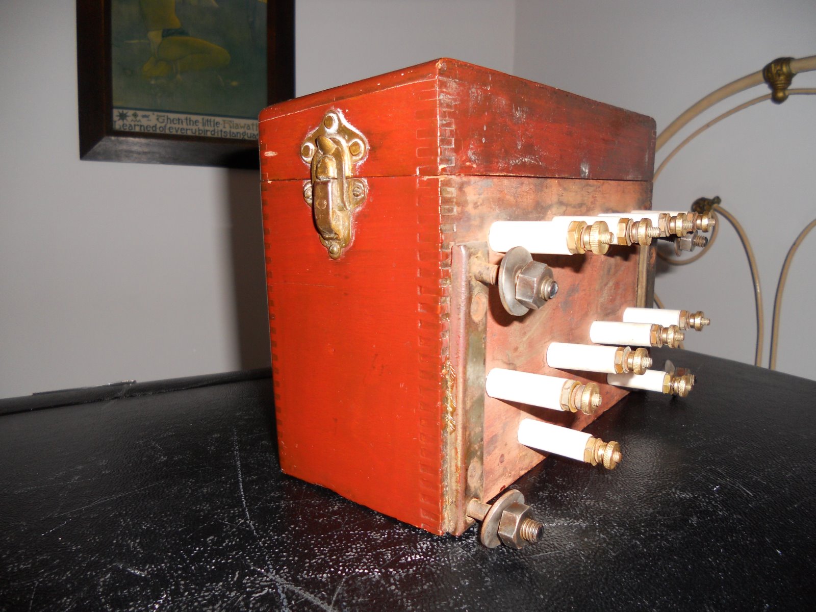

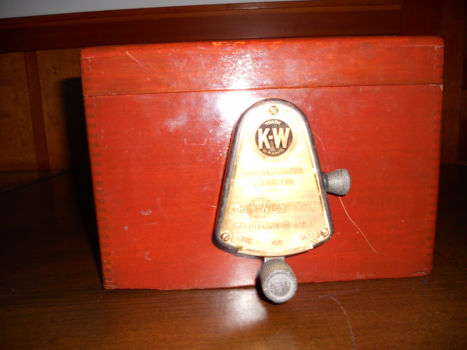

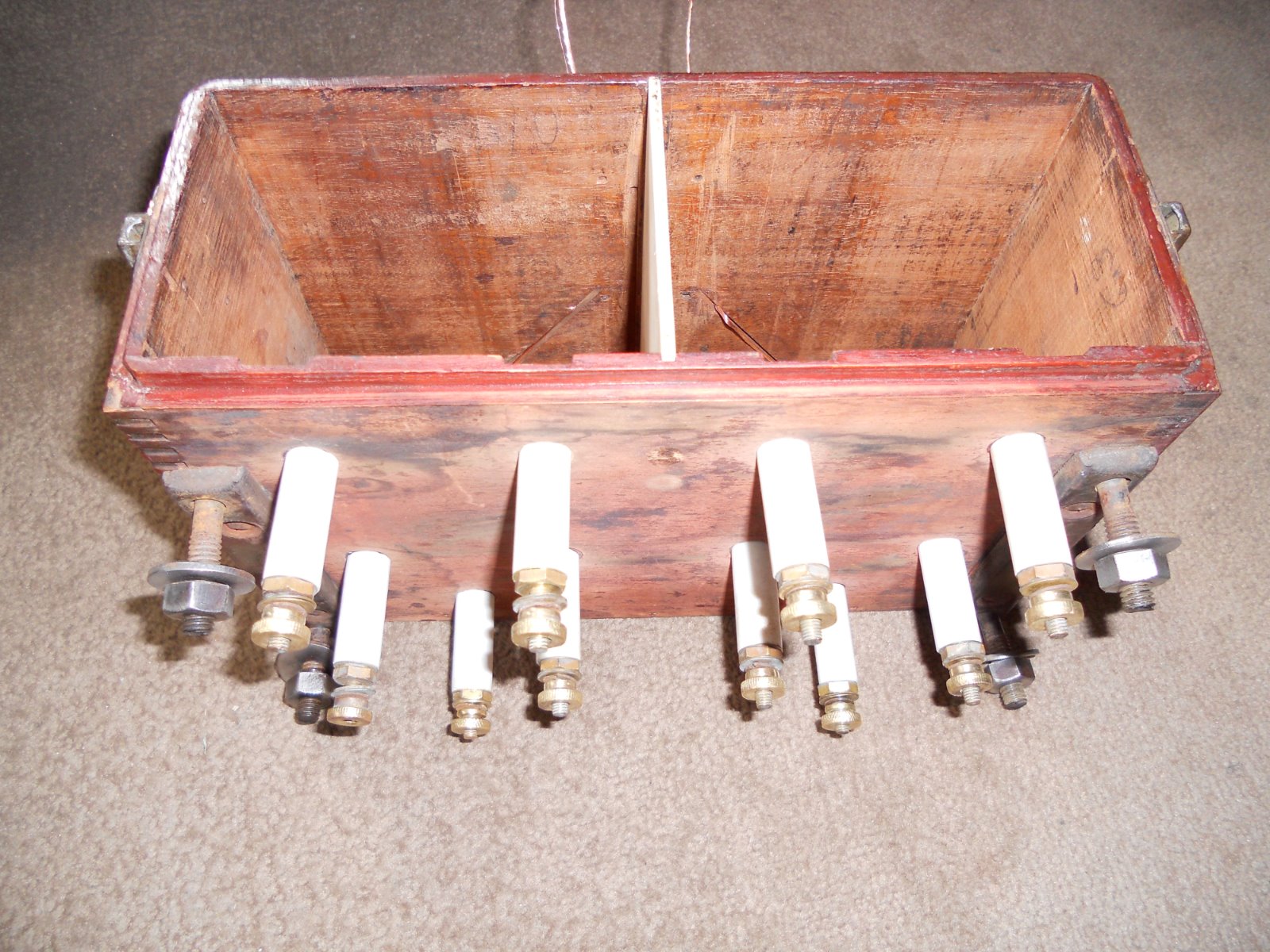

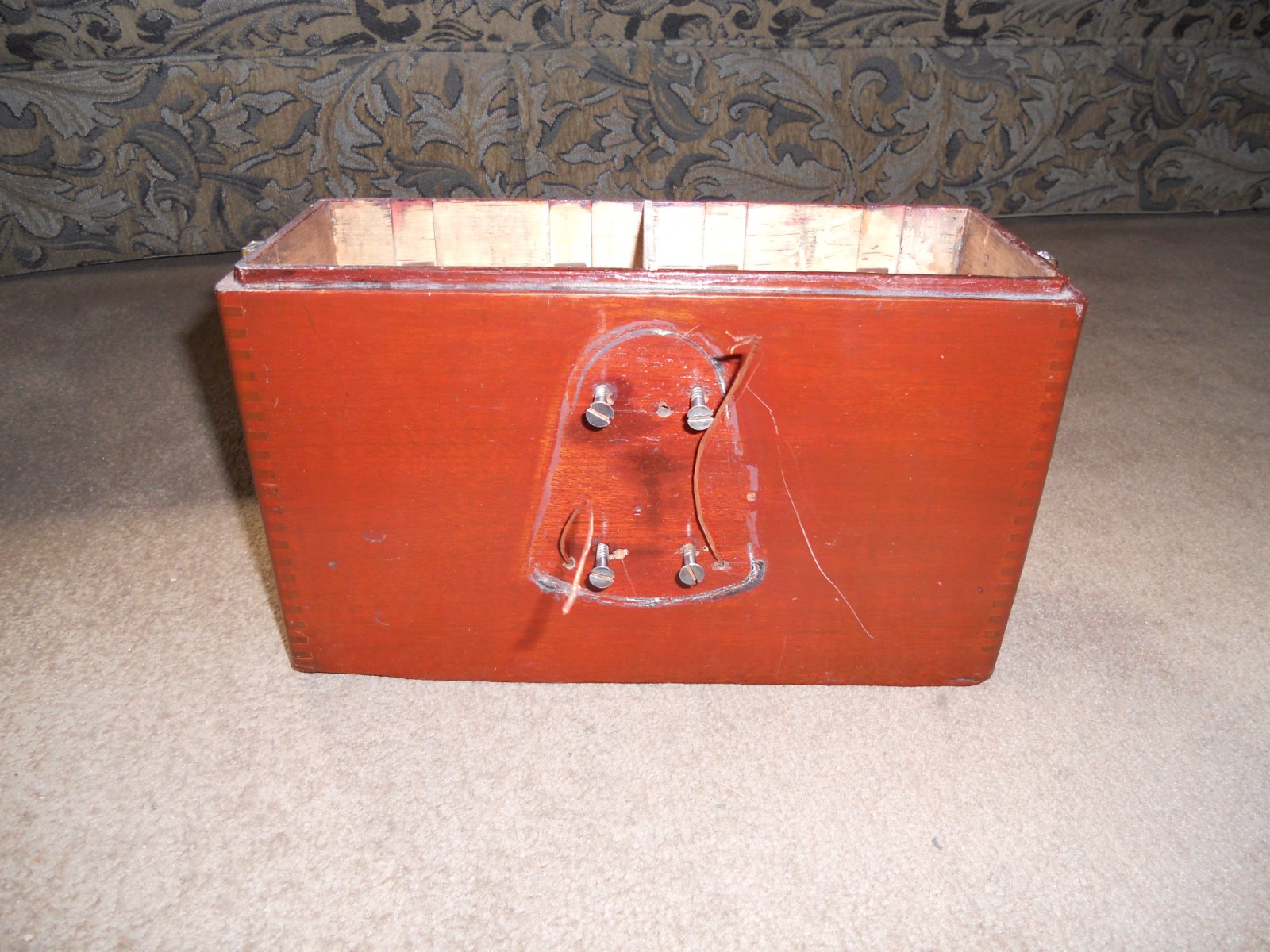

Here is a photo of a KW box I picked up two or three years ago. It even had three original coils in it, no switch, porcelains, or contacts inside. With a week I had it on the car, and running. I didn't refinish it.

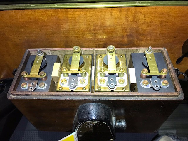

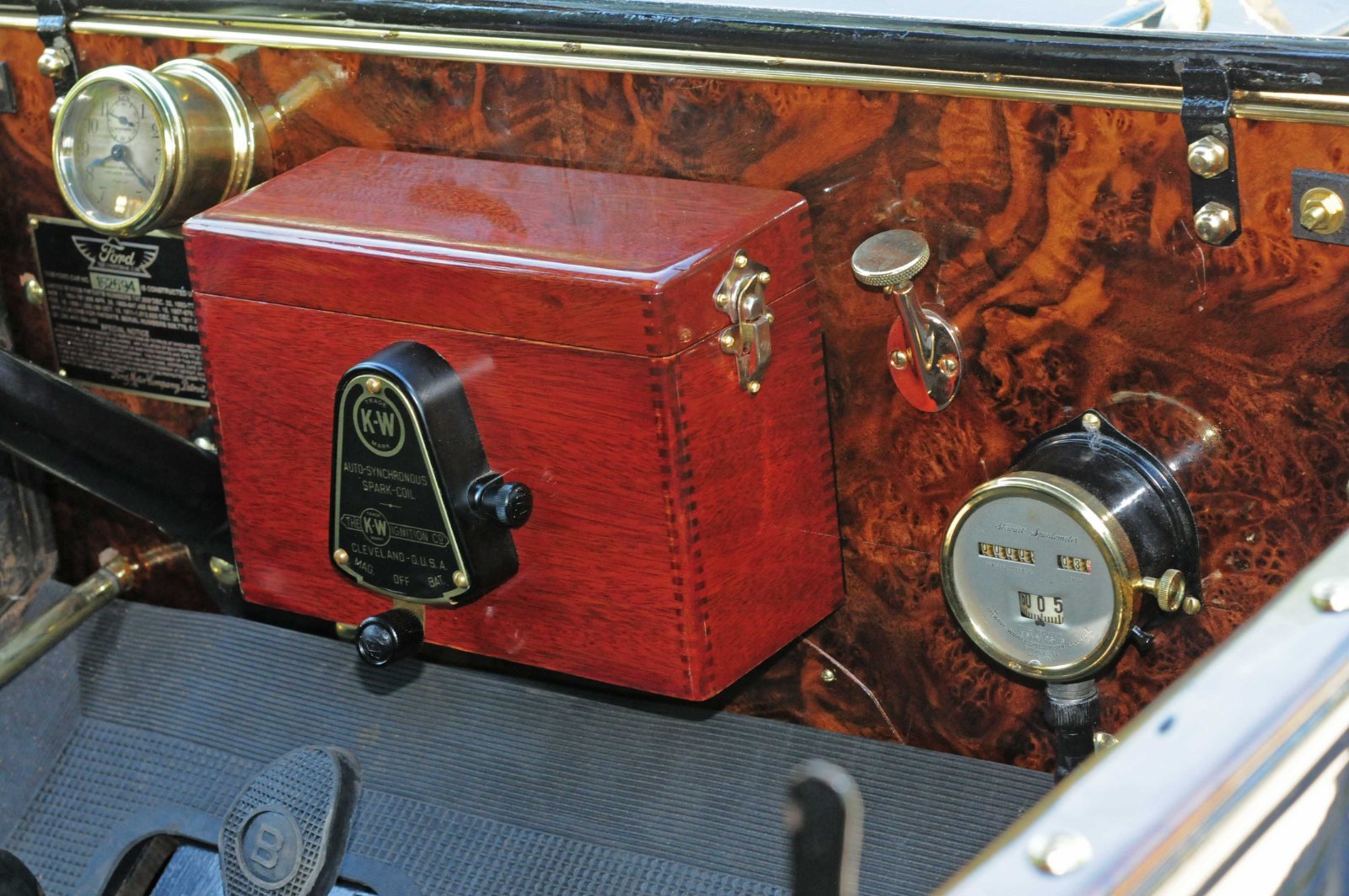

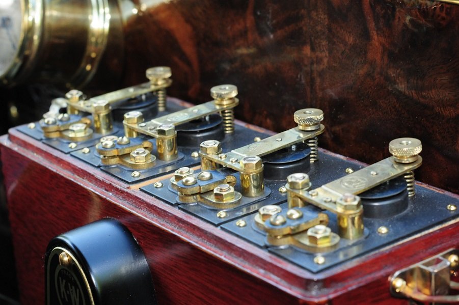

Post by MikeSommers » Sun Apr 07, 2019 10:17 am
My U.S.'13 has a block date of April 3, 1913. It had a metal coil box, but it I was told that there was an 'upgrade' program that allowed owners to swap out their old box and coils for a new and improved metal box and coils. I talked to RV Anderson, and he felt that an April 1913 T would have been built with the dwindling supply of wood boxes. And the coils in these wood boxes are slightly larger then standard coils. I had him build a 1913 period correct box and coils, which look fantastic. Although not cheap, it is a showpiece for the car. Given that you have earlier parts in your car, I would go with the wood box.

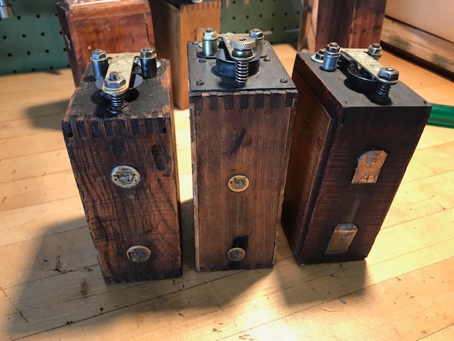

Daren, here is another option to consider. I have a 1913 with an original KW coil box. I use later more modern coils with brass strips soldered to the contacts and wood spacers in the coils box. See 2 pictures: 1) the coils in the box with spacers. 2) 3 coils: later one, 1913 one with lower contacts, and a later coils with the soldered strips.

Re: Identifying correct coil box for early 1913
Post by Original Smith » Thu Apr 11, 2019 11:42 am
I made the divider from a piece of wood I found at a hobby shop. I cut it to fit, and it slid right in. This is the piece in the center of the coil box.
