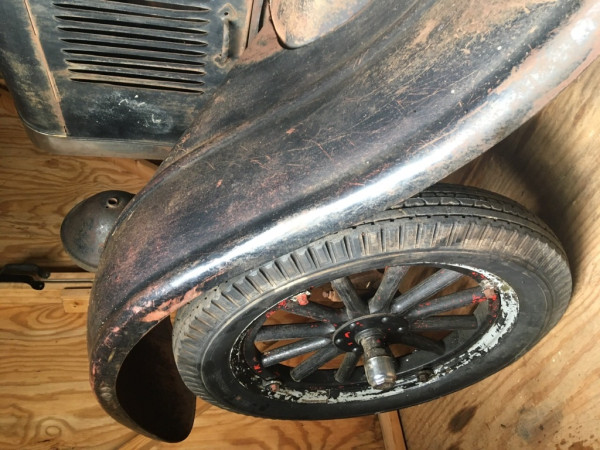

Hey still learning here. Trying to figure out the different rim styles/names. I have a 26 Tudor and am wondering what type of rims or the name of the rims I have.

Those were split rims.  They were standard for that year.  They also came with wire spoke wheels which cost a bit more.

Felloe.  The circular part into which the outer ends of wood spokes are fastened. The earlier Felloes are wood and the later ones are steel.  Rim, the outer part which holds the tire and is attached to the Felloe   Many of these terms come from the days of buggies and wagons.  Even the type of wheels used for the early cars are constructed like wagon wheels.

I here the term clincher rim often and didn’t know the difference. Also should the split rims have a locking tab on them? And Iam assuming these split rims are considered de mountables ? Basically when I go for new ones I will know what to ask for

Bryant, yes you have demountable split rims. There should be a locking tab, you will not see it with the rim on the wheel.
