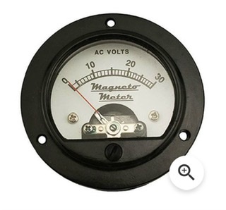

Since a alternator in a Model T converts the current from AC to DC am I correct that a volt meter for that alternator should also be DC but that a voltmeter to read the magneto output should be AC?
- Posts: 8645
Re: Geared Alternator at Low RPM’s
The regulated output from the alternator will be DC, so the regular add-on type volt and ammeters sold at auto parts stores should work. An ammeter doesn't care about voltage, within reason, and a 12 volt automotive voltmeter ought to work all right on a 6 volt system. I don't see a problem using the stock Model T ammeter with an alternator, as long as the altenator output did not exceed about 20 amps. Fuses ought to be used.

My question was more geared as to whether one uses a different type volt meter on their dash to read current from the alternator or from the magneto. The vendors sell a cool meter pictured below to read the magneto but since the face states “AC” can I assume this same type could not read the DC coming off the alternator?TXGOAT2 wrote: ↑Mon Oct 25, 2021 9:32 pmThe regulated output from the alternator will be DC, so the regular add-on type volt and ammeters sold at auto parts stores should work. An ammeter doesn't care about voltage, within reason, and a 12 volt automotive voltmeter ought to work all right on a 6 volt system. I don't see a problem using the stock Model T ammeter with an alternator, as long as the altenator output did not exceed about 20 amps. Fuses ought to be used.
PS-If I did this I would use separated meters. I know to never allow DC battery voltage to go to the magneto.
- Posts: 8645
It's somewhat confusing. What is called the magneto on a Model T is actually an alternator, and it puts out unregulated AC current only. Modern alternators also make AC current, but they include an electronic rectifier set to change the AC to DC and most now in use have an electronic regulator circuit to control voltage and current. The magneto meter for Model T use will not work * correctly on the rectified DC output from a modern alternator, but you can still add one to your T, just be sure to connect it to the magneto as per instructions, and not to a generator or modern alternator.

Yes 2 different meters. The alt is putting out DC. The T ammeter can be used. The AC meter is only for reading magneto output.MichaelPawelek wrote: ↑Mon Oct 25, 2021 9:59 pmMy question was more geared as to whether one uses a different type volt meter on their dash to read current from the alternator or from the magneto. The vendors sell a cool meter pictured below to read the magneto but since the face states “AC” can I assume this same type could not read the DC coming off the alternator?TXGOAT2 wrote: ↑Mon Oct 25, 2021 9:32 pmThe regulated output from the alternator will be DC, so the regular add-on type volt and ammeters sold at auto parts stores should work. An ammeter doesn't care about voltage, within reason, and a 12 volt automotive voltmeter ought to work all right on a 6 volt system. I don't see a problem using the stock Model T ammeter with an alternator, as long as the altenator output did not exceed about 20 amps. Fuses ought to be used.
