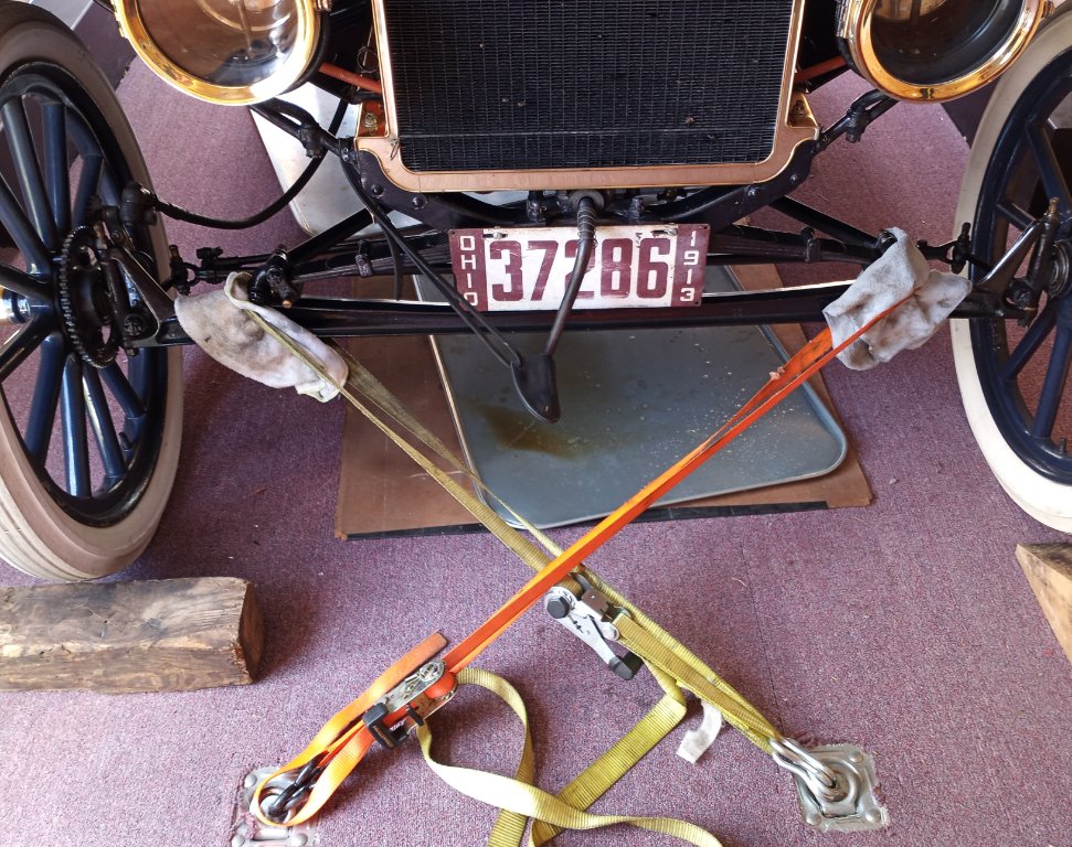

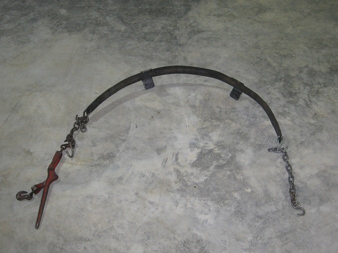

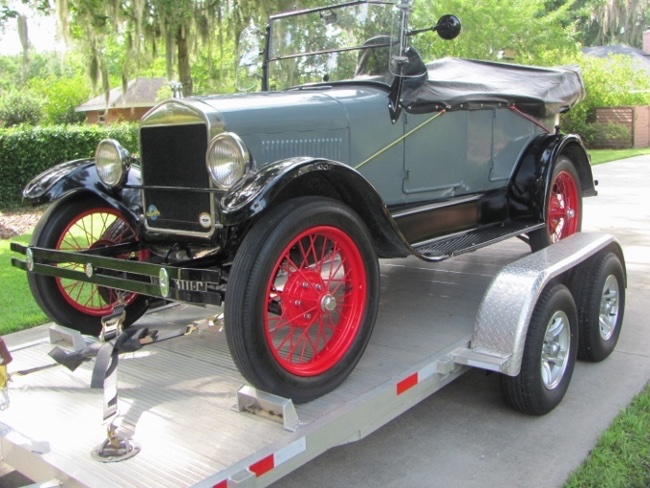

Re: How Tiedown a Model T to Trailer
Like oil and electronic timers, you'll get many responses and ideas. Here's what works for me. I actually use 2 of the heavy yellow straps. This was old pictures when I lost one! Hauled cars like this thousands of miles with no problems. The rear axle I just use two straps straight back. Chock the wheels, set the brake, pull the key!
- Posts: 3743
- Last Name: Wrenn
Sorry for double pics. Crazy phone!
- Posts: 5245
I Like Norms hints. Heard the pros & cons of the various tie down methods.
I hate the idea of putting a pull on axles, unless I am trying to pull a pushed wishbone mount back into position during the trip. Over cautious? Maybe, but not sorry. Otherwise.
23 & earlier frame corners only(pre diaper) front & rear. In my enclosed trailer, rear frame nearly straight down, chained with a load binder. Straps added outward as a safety redundant. Front frame corners wide, but, clear tires. Tight.
Post diaper- inside wish bone with lightest necessary tension. & add at least one backup strap. chocks front & rear. (12" 4x4's with 2 perpendicular 12" 1x4', mounted under the 2 ends. They have never moved)
If/when I go long distance or mountain routes, I will strongly consider removing the diaper for transport In the "pre diaper tie down state."
I will listen for a better way.
I am content to trailer with long straps used with short axle straps, I cross strap front to rear. My 2 enclosed cargo trailers have had floor pockets installed. By cross strapping front to back I am not pulling the front axle & wishbone out of the "socket" in the oil pan. Straps are tight, but not over tight so as to not pull extremely hard on the axles. This trailer is a 2016 Alumia 7x14 cargo extra height for clearance of the windshield of our open express. I have another enclosed trailer that goes from New York to Florida in the wintertime, that is a 7x16 Snapper extra height also, half the quality at half the price but it works. That being the white trailer & the Homemade pickup we cruise Florida with. I also have an open trailer that we have used to trailer with, have gone as far as Central NY to Virginia, less drag to tow with but a pain as everything that can get loose needs to be secured or removed & placed in the back of the truck, when needed we cross strap front to rear also. George

Haul on open trailer a lot. But had cover made to fit over the open car compartment, covering the top boot too. If your top is folded down, consider adding a top boot, or at min. several bungee cords to restrain that top cover from becoming a parachute behind you!
Same deal with straps, I cross them, on the axles, front and rear, for side control. Like to let the T's springs provide some cushion to the car along with the trailer's torsion axles. Anchors at front wheels, and brake on and key out!

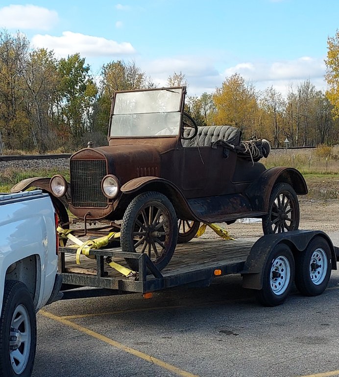

Thanks everyone. Some very good suggestions. I am now trailering my new to me T home. Did the criss cross straps method with the front wheels against the Jelf stop. Speeds below 45 mph. Floor boards and seat cushion removed, and top down and tied up.

I spent many years hauling race cars around the US Northeast. I would never tie down a car by the axles. Ever. I use two tiedown straps front and rear and use the outer front crossmembers and crisscross the front straps. I grab the frame on either side of the center spring mount and attach the straps to an attaching point in the center of the trailer's floor. This prevents the body from flopping all over the place. Some will disagree with this, but it has worked for me foe more then 50 years. I also would not tow a Model T (or any car of that vintage) on an open trailer at speeds over 50 MPH.

Success! Thanks for the advice and recommendations.

Yes, new to me, I am the third owner. In storage since the 1950's. Complete, correct, and unmolested.
