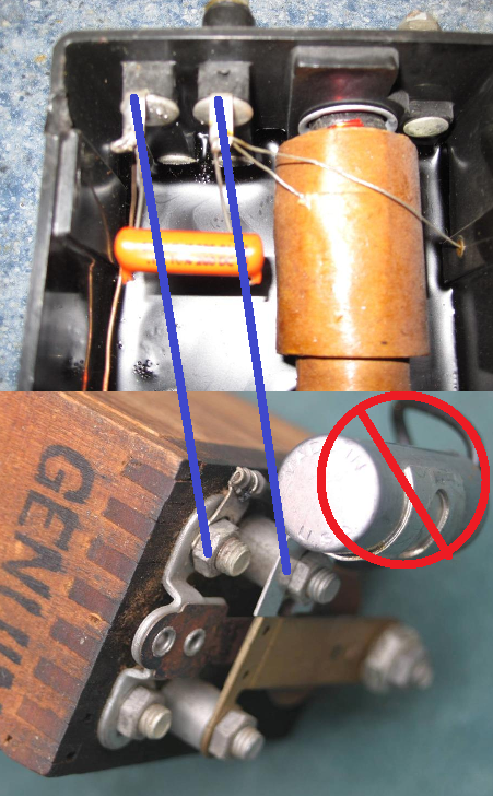

Is it possible to add a capacitor on the trembler coils directly? I mean in a way that I do not have to dig into the coil to replace the internal capacitor?

Yes. seen it done. Make sure it clears the coil box lid. My feeble memory says it can be placed out on a terminal post. Dont quote me on this. Might be worth confirm/deny. In fact, A coil wizard will be visiting . Ill ask directly.

I am not advocating doing this but it has been done by others as a temporary fix.
http://www.mtfca.com/discus/messages/50 ... 1424318130
Doing it the right way may be easier in the long run when trying to protect an external connected capacitor to the coil posts from shorting when securing the lid. The lid is needed to keep the coils form moving and loosing their contacts. Its also important to use the capacitor matched to the coil so maybe there lies the problem. http://www.mtfca.com/discus/messages/80 ... 1248132830 --

At Chaffin's we use a 0.47 uf, 400V polypropylene capacitor with a dV/dt rating of 6000.

Definitely a temporary fix, and only for an open circuit internal capacitor. If the internal capacitor is excessively leaky, then no amount of external capacitance will fix the problem. Also, if the internal capacitor is open circuit with an intermittent connection, if the connection comes good then the amount of capacitance is increased - not that it will stop the coil functioning.

I did speak with my coil genus. Must be connected between upper & lower points. If you want to drill a hole or holes, you can in theory have 4 remotely mounted any where.speedytinc wrote: ↑Sun Oct 31, 2021 10:07 amYes. seen it done. Make sure it clears the coil box lid. My feeble memory says it can be placed out on a terminal post. Dont quote me on this. Might be worth confirm/deny. In fact, A coil wizard will be visiting . Ill ask directly.
