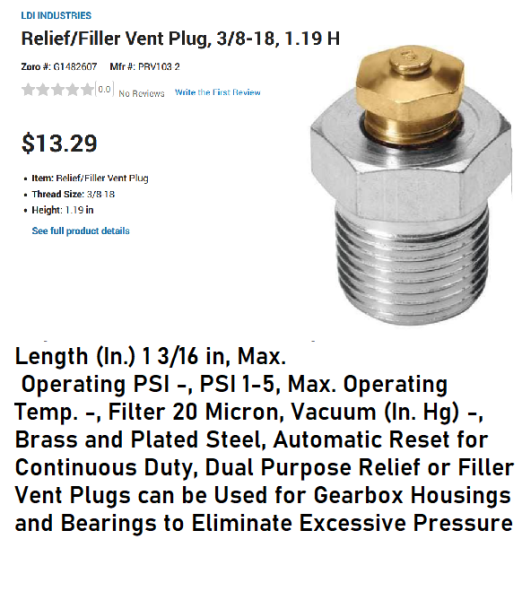

Re: Gas Tank Pressure Pump Plumbing?
Don't know but found these https://www.zoro.com/ldi-industries-rel ... ifications
- Posts: 8706
That will vent pressure, but apparently it does not have a vacuum relief function. Any relief device would be subject to failure, and might lead to serious issues.

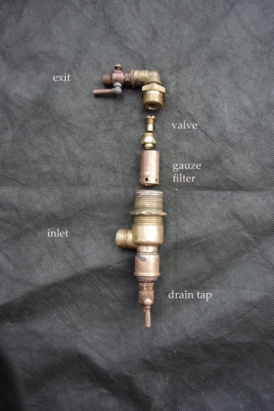

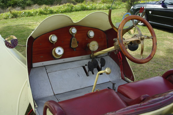

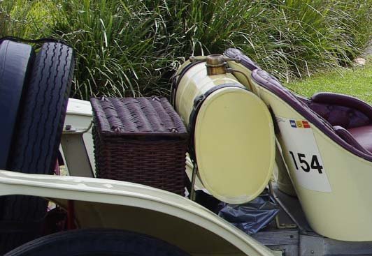

This is a simple set up, I have a speedster which has for the last 50 plus years had such a system. never fails.
hand pump connected to the neck of the fuel tank, connected by copper tube. with a low pressure gauge inserted. pump is in floor.
Pump up to 1 to 2 PSI. Sometimes if I drive a big distance I might have to get the wife to do a few more pumps especially if going up a steep hill. Usually on a sunny day the heat from the sun will keep it pressurized. Obviously the system has to be air tight and the pressure is let out by loosening off the gas cap.
I also have an exhaust pressure system as well , just a connection to the ex pipe through a expansion chamber to the pipe to the tank with a check valve to stop the hand pump air from going out the exhaust pipe. Its made out of normal plumbing pieces.
