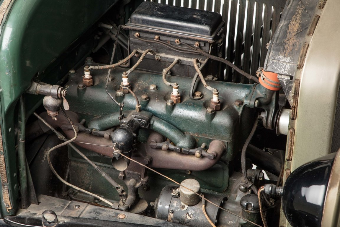

Post by Humblej » Thu Nov 11, 2021 6:43 am
Found this picture of the 15 millionth model T. This one looks like Model A engine green and frankly this engine color is questionable since the body has been repainted the wrong color two different times, the engine could have been repainted at some time too.
