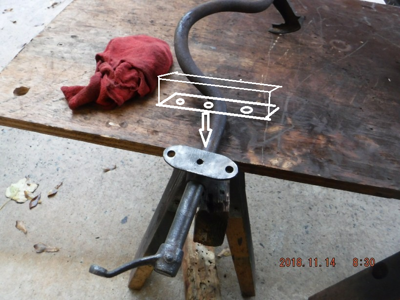

Once the control shaft is removed don't forget to clean out and maintenance the oiler holes :o
http://www.mtfca.com/discus/messages/82 ... 1542391088

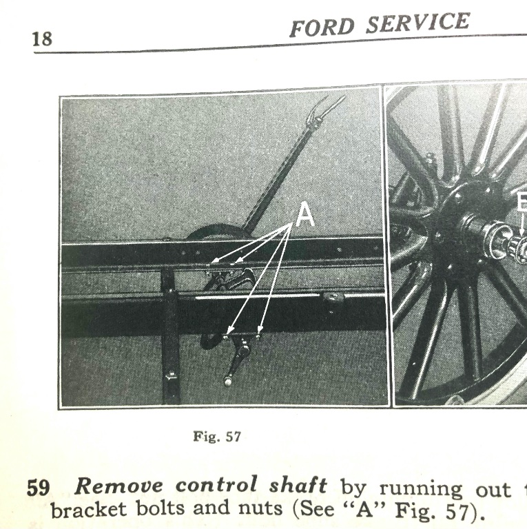

You can refer easily to Ford Service, paragraph 59 to remove and paragraph 67 to install that control shaft.

Thanks all. Dan - I looked all over the darn manual for that page - One would think "handbrake" or Pawl or control quad etc would have pointed there! Anyway looks and sounds easy enough. Thanks!
