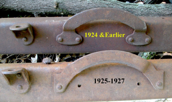

Post by Steve Jelf » Thu Nov 25, 2021 12:37 am
On a car, 4 rivets = 1924 & earlier; 2 rivets = 25-27. Does this apply to trucks also?

Post by kmatt2 » Thu Nov 25, 2021 3:26 am
Yes the TT switched over to 2 rivets in 1925. Also for general information, the TT hand brake uses a taller cam lever due to the taller frame if you are looking for a hand brake at a swap meet.

Post by Original Smith » Thu Nov 25, 2021 10:30 am
Notice too, the lower photo is an early 1925 frame, using up the last of the 1924 style frames.
