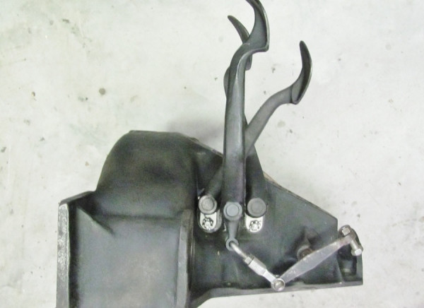

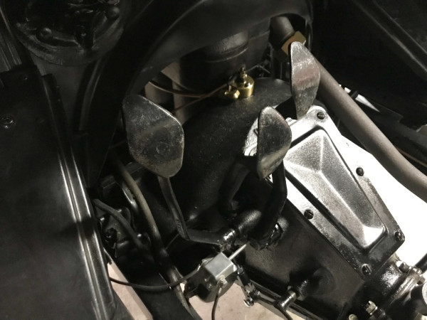

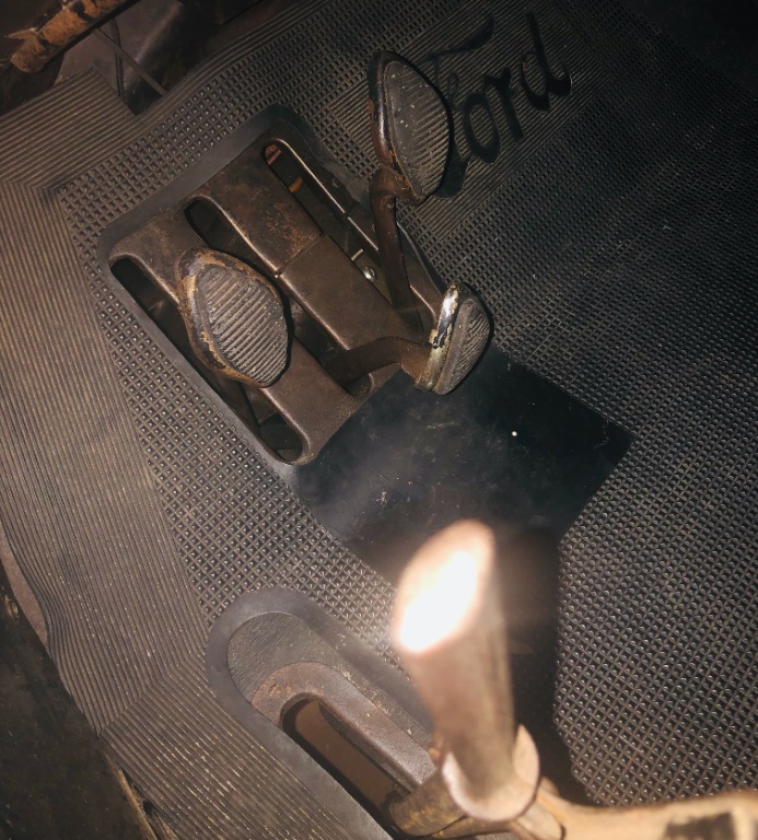

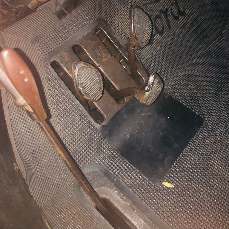

Here are a couple shots of my pedals, does the low pedal look like it needs to be bent upward? This may be the route I take.

Yes it do. @ rest, the brake & clutch pedal should be @ the same level If your clutch linkage is properly set.
I would confirm that first. See 1 manual. Your replacement pedal shaft may not have been drilled in the right spot. Cant blindly trust a repo part.
- Posts: 4694
Re: Low Gear Engaging Too Late
If the parking brake lever is all the way forward, your pedal is bent. It should be back as far as the brake when it is at rest. This is a common problem caused by a lot of use of the low pedal and pressing very hard. I have had good results by using a very large wrench such as a pipe wrench about a foot and a half long. I just put it around the shaft and pull back hard. Do not heat the pedal shaft. Or you could look for another pedal. But since you welded it, it would be hard to change.

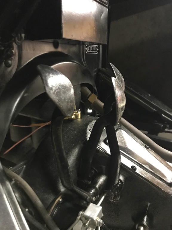

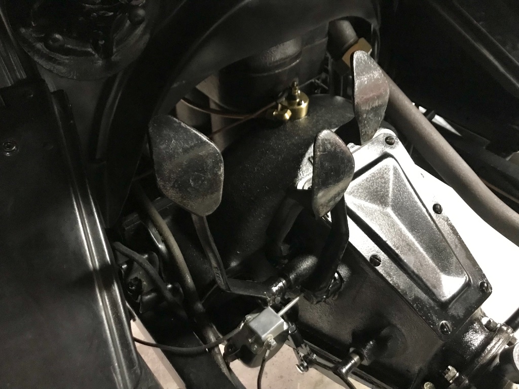

Typical relationship of the pedals. You may have to bend your low speed pedal back, as it may be deformed as posted by others.
Hand lever forward, clutch engaged, low speed pedal approx. above level of brake pedal.
Hand lever pulled back 1/2 way to 'neutral', low speed pedal advances some, now lower than brake pedal.

Great picture showing the side-on view of the pedals! I saved that one for future reference.

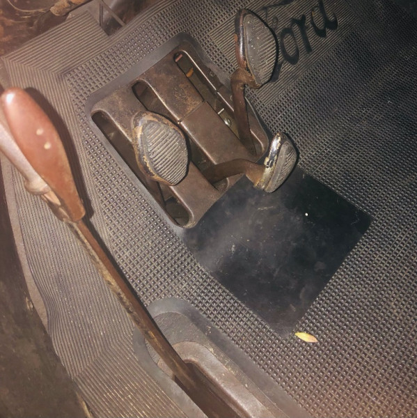

My T is a '27 with the wide pedals. My low/high pedal is the same height as the reverse pedal, and the brake pedal is lower. All of the pedal-controlled systems work properly.
