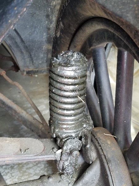

What is the brand of these shocks? I am missing a coil spring cover.

Post by RajoRacer » Tue Mar 05, 2019 8:58 pm
Could be KW Road Smoothers - they look similar.

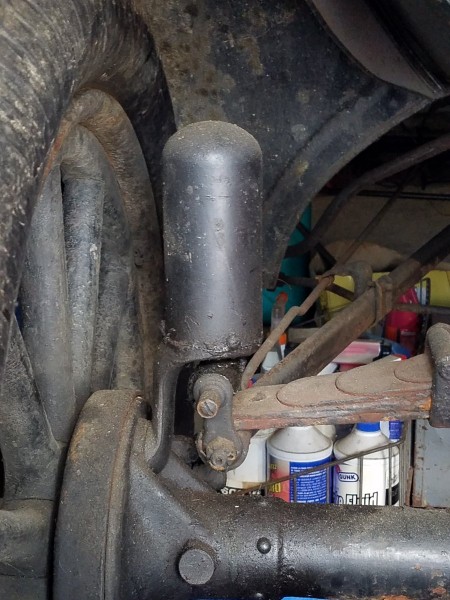

WANTED
Cover for this Fordezer shock.
Will take whole set or parts.
Thank you.

Post by TRDxB2 » Sun Nov 21, 2021 11:41 am
Pretty sure they are FORDIZER. However I don't have a good picture of the top of dust shield as being flat or rounded (Hartford). The perch neck look the same as the FORDIZER but to further confirm just see if there are holes in the base to hold the dust shields. Based on the perch alone I would vote for FORDIZER. Do you have front shocks as well?
