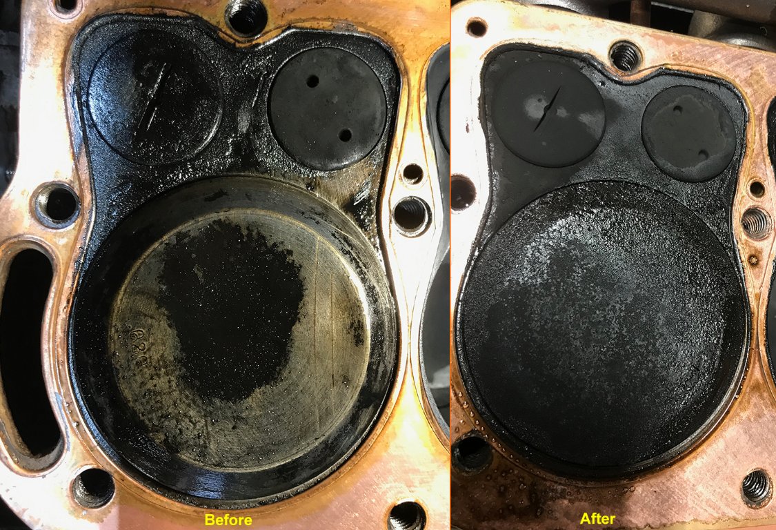

Ring Job
My friend with the 1922 has been using a lot of oil. We pulled the head and there appears to be a fair amount of burnt oil. I've attached photos of the #1 piston soon after he bought it last summer and when we pulled the head again a couple of days ago after maybe 400 miles. Compression was 40 psi (cold). The cylinders are shiny and smooth with no scoring. My question, does replacing the rings usually help in such instances?

Re: Ring Job
When was the last time the valves were adjusted? By the dry soot present on #1 exhaust valve, Not advancing timing with RPM and or running to rich which in turn causes polished/washed cylinders. Remove lower inspection cover and check with a feeler gauge piston to cylinder clearances at the lower skirt in 90 degree intervals. Might get lucky with rings but I suspect other issues will need to be addressed.

Re: Ring Job
Those look like the old two-piece valves. If they are, I highly recommend replacing them before the implode inside the engine!

Re: Ring Job
I have found that more oil is burned via sucking up through worn valve guides than from bad rings. T's don't have oil rings per-se anyway.
I would suspect that with this much oil (by your description) being burnt showed up more at idle as some smoke while idling and not really that much if at all while actively going somewhere.
Check what Hank suggested...but before buttoning anything up, give the valves a wiggle and maybe pull one and measure the valve guide clearance in 3 places and I'll bet you'll find a lot of wear.

Re: Ring Job
I agree with Keith about the valves. Also the compression is quite low. Is it even between the cylinders? If low, you either have a valve problem or a ring problem. You can check the bore from bottom of the cylinder to the top and also across the cylinders. Also if the pistons wobble in the cylinders, they are too loose. Smooth bores indicate you are not scoring the cylinders. So you might not need to rebuild the whole engine. If it does not have a significant knock, you might get by with only rings and valves. This work can be done without removing the engine, however, if you have a 4 dip pan it is much easier to do number 4. Be sure to stagger the rings so that the gaps are not all on the same side. It is much less likely to burn oil if they are staggered. If you don't have a gauge to measure the width of the cylinders, you can take a ring and a feeler gauge. measure the gap toward the top and toward the bottom of the cylinder. The difference is then divided by pi and that would be the taper. To measure whether the cylinder is round, turn the piston 90 degrees and measure. then put a feeler gauge between the piston skirt on the side perpendicular to the wrist pin. Do this in at least two directions and measure at the same place on the piston. They should be nearly the same. Then use a hone and scuff the cylinder walls before you install the new rings. If the block has been rebored, there is usually a number stamped on top of the piston which would give you the oversize of the bore.

Re: Ring Job
New Model T pistons are very cheap. Besides the condition of the cylinder bores and piston skirt wear, the condition of the piston ring grooves has a considerable bearing on compression and oil control. The fit of the piston is the bore is important, the condition of the bore is important, and the condition of the ring grooves is important. If careful measurement indicates that the cylinder bores are in good condition, they will need to be lightly honed in the proper crosshatch pattern to assure that the new rings will seat. As pointed out, the condition of the valve guides and valve stems will affect oil control as well as engine idle performance. Putting new rings in an engine with excessively worn pistons or excessive bore wear can actually make oil consumption and compression loss worse.

Re: Ring Job
My engine smoked particularly at idle. Compression at 60. 5000 miles on rings, not bored. Thought the problem was loose valve guides. Stem cearance was .006 to .010 in. Reamed guides and new valves. Problem still existed.
I was making sure that the oil would gush out the upper oil valve so that everything was well oiled.
Reduced the oil level to half way between the valves and the problem went away. This oil level has been recommended quite frequently on the forum. I wish I would taken this advice a long time ago. My friend found the same thing.

Re: Ring Job
In the past my engine had 40 psi compression.
Ground the valves now had 50 psi.
Later. New rings not bored. Compression at 62 psi.

Re: Ring Job
No salt in a wound but your buddies engine appears to be a junkyard rebuild with a mix of parts from other worn motors. Seen way too many of them. The transmission is probably from the same family.

Re: Ring Job
A car that sat for ten years could definitely have stuck rings. If that was my car, assuming it is in roadable shape and free of knocks or other indications of serious engine problems, aside from oil consumption, I'd put fresh, high quality oil in it, such as Rotella 15/40 for diesel service, which has a high detergent/dispersant level, and drive it out on the road at up to 30-35 MPH for a few hundred miles. I'd also use Marvel Mystery Oil as directed in the fuel tank. Check the oil level and condition frequently. Add oil as needed to keep the level about halfway between the gauge cocks. If the oil becomes thick and dirty, change it. The engine may free up and run well with minimal oil consumption after some road miles. If not, no harm done, and you'll have had a good chance to assess the overall condition of the car in actual service, and you'll have had the pleasure of driving it without the up-front investment of considerable money and effort. Have your friend advise you as to how to use the spark and mixture controls to the best advantage to avoid any unnecessary soot or carbon deposition. Perform carburetor repairs and ignition system repairs as needed. Clean plugs as necessary to prevent misfiring.
